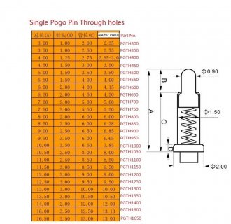

I want to use the USB Host and under-side solder pads on a Teensy 4.0. Available breakout boards use pogo pins per this link: https://www.pjrc.com/breakout-board-for-teensy-4-0/.
I have not used these components before and I have questions:
1. I need to reconcile the PJRC directives regarding pogo pin height for the Teensy 4.0 breakout board. Specs say to use 12mm to 12.5mm. Digikey has three different categories relating to this, but I'm not sure which one I should match up to make sure I get correct components. Help?
2. The breakout board site has an old link to components, but doesn't offer dimensions. What is the hole size for the the necessary pogo pins?
