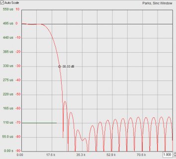

Below is version 1.5 for people to try out. By default it uses a 32-tap polyphase FIR interpolator/decimator now. That adds around 1.5% to the CPU load (per filter) compared to simple linear interpolation. You can switch between linear and polyphase FIR interpolation by setting the filter parameter "interpMethod" to LINEAR or FIR_POLY respectively.
Let me know what you think.
Cheers,
Richard.

Thanks Mark, the trade-off here off course is stopband suppression versus potentially audible HF rolloff in the passband within the constraint of no more than 32 points.
I have tried a few more 32-point designs and have settled on this for now:
You might get a better response with the Remez algorithm rather than the window method?
I tried a few designs using Parks McClellan, and decided in the end to let the filter be just marginally longer. This one is 36 taps, derived from a 40-tap specification that had very small end coefficients.
I think I'll leave it at this for now. It sounds pretty good to me. Here is the updated .h file. If you prefer the previous 32-tap filter, you can uncomment those coefficients instead.

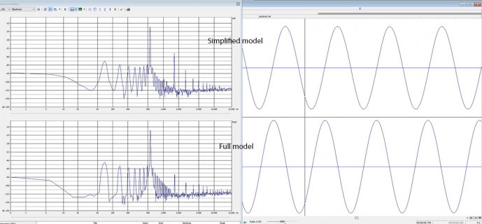

For those of you who are interested in this sort of thing, here is a comparison of the current filter based on Huovilainen's simplified model with his full model. Input is a very low level 70Hz saw, and both models are running at strong self-oscillation with the filter tuned at about 550Hz. You can see the simplified model shows higher level harmonic distortion of the 550Hz self oscillation frequency compared to the full model (eg around 3x the fundamental at around 1600Hz), presumably due to the use of a single tanh function rather than one for each LPF stage. In agreement with the statements in the simplified-model paper, it's a reasonably good approximation to the full model at lower resonance, but less so at higher resonance, where it starts to sound different.
edit - I should mention this was with the filter set to an extreme resonance of 1.8 to get the self-oscillation level to better match that of the full model level. You can audibly reduce the sine distortion by winding the resonance back closer to 1.0, but the self-oscillation becomes significantly less prominent. Personally, I think I prefer a resonance limit of around 1.2 with this filter. There is also significantly increased aliasing when you push the filter to very high frequencies at these extreme resonance settings. I'd like to hear from anyone who has tried the filter, whether they agree that 1.8 is too high, and whether we should perhaps reduce the maximum available value of that parameter.

Hi Florian, good to hear you're enjoying the filter. On my system, I get 7% for POLY_FIR, and 5% for LINEAR. To reduce it further I suggest going to 2x oversampling. However, that requires a different set of FIR coefficients. The ones from the newer filter that already runs at 2x should be fine, but they are 32pt rather than 36 so the changes to the .h file include changing both INTERPOLATION from 4 to 2, and interpolation_taps form 36 to 32.
The coefficients needed in the cpp file are:
static float AudioFilterLadder ::interpolation_coeffs[AudioFilterLadder::interpolation_taps] = {
-129.6800658538650740E-6, 0.001562843504973615, 0.004914813078250063, 0.007186231102125209, 0.002728024844356039,-0.007973931496234599,-0.013255882861166815,-841.1646993462468340E-6,
 0.022309967341058432, 0.027240071522569135,-0.007073857882406733,-0.056523975383091875,-0.055929860712812876, 0.042278471323346570, 0.207056768528768836, 0.335633514003638445,
 0.335633514003638445, 0.207056768528768836, 0.042278471323346570,-0.055929860712812876,-0.056523975383091875,-0.007073857882406733, 0.027240071522569135, 0.022309967341058432,
-841.1646993462468340E-6,-0.013255882861166815,-0.007973931496234599, 0.002728024844356039, 0.007186231102125209, 0.004914813078250063, 0.001562843504973615,-129.6800658538650740E-6
However when I tried this I discovered there is a bug in the code of the poly update routine that only shows up if you are not using 4x oversampling. Specifically, in the inner loop the indexing into the audio block at input/output currently uses "i*4" but it should be "i*INTERPOLATION"

As an aside, from the brief listening test I did it seems to sound surprisingly (to me) similar to the 4x OS version. So if Paul is happy to incorporate the 2x option into the library version of the filter, perhaps 2x should be the default. The max CPU usage measures I see with the various configurations are:
4x poly 7%
4x linear 5%
2x poly 5%
2x linear 4%
(is there a way to see fractional % ?)
When %CPU is less critical, I highly recommend trying the full model filter instead which has far lower 'tanh aliasing' at high resonance.
