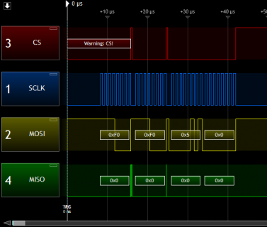

i found, that the initialization for non-native CS is in the wrong order in (minimum) two spi libs:
Example:
if you try:
the led stays off.
this, instead works:
So.. the order of setting pin-direction and value is important.
Let's look at flash_spi.cpp:
..so this does not work, i think.
SPIFIO:
is the wrong order, too.
Maybe there are more places that need to be fixed ?
Together with missing pullups, i think this causes problems at the time when the very first initialzations are done, because more than one SPI-Device is selected.
Edit: tested with Teensy 3.1
Edit: could this be an explanation for some strange effects ?
