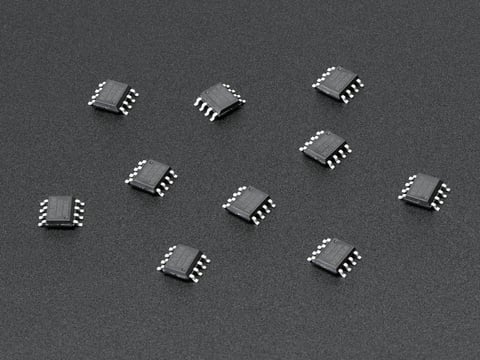

You can get the WS2811 as single chips. These one are on the 12V LED strips, where one chip drives 3 RGB LEDs.
I don't know if or how it would be possible to use them with low current LEDs.
