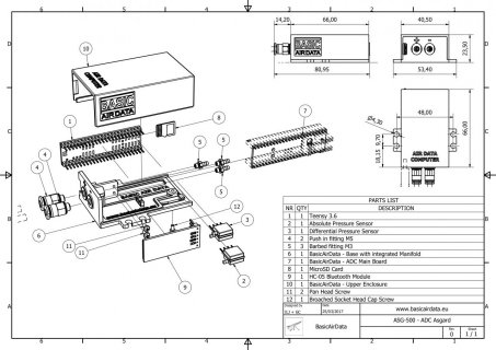

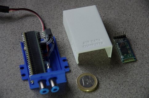

We have posted here a project for a versatile DIY air data computer. (some pictures here). Project is always under development. The Teensy 3.6 board was the natural choice for us, plenty of I/O and elaboration power.

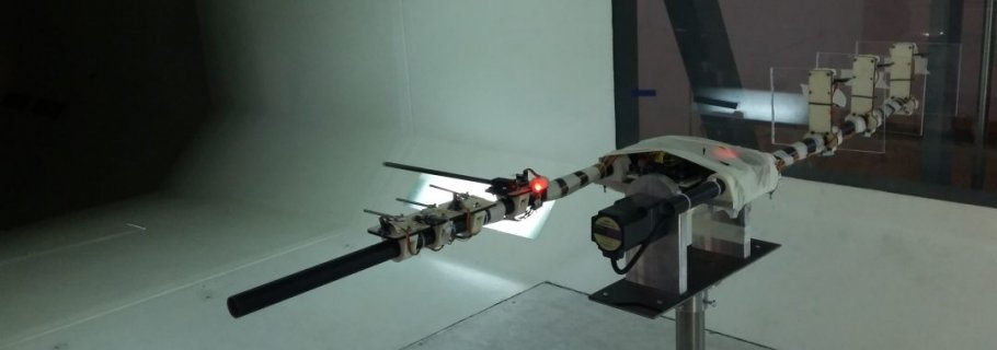

You find in this link applications for an ADC. For example you can use the ADC with a DIY Pitot Probe to measure airspeed. (Wind tunnel tested).
