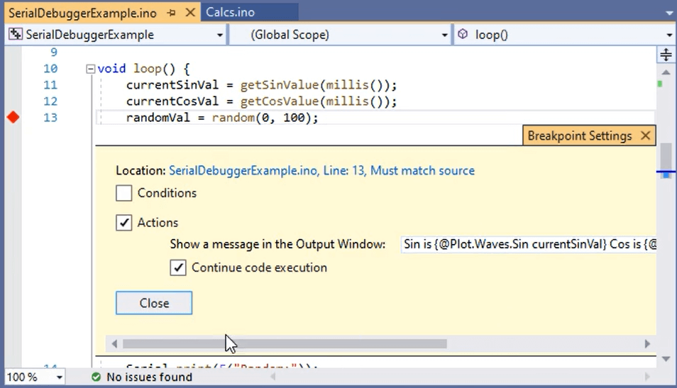

We have a created a Debugging tool compatible with the Teensyduino platform, for all Teensy boards, running over the Serial port. This is part of the Visual Studio development extension Visual Micro.
This allows you to:
  • Step by Step execution using breakpoints
  • Performance Monitoring for execution time between breakpoints
  • Conditional breakpoints (based on data or hit count)
  • Variable monitoring with automatic min/max tracking
  • Change variables at runtime
  • Automatic Visual Pin monitoring
  • Easy to use Charting (for any data)
Code Example (all features use standard breakpoints):
Example of Charting Running, with data tracking and Min/Max data visible:

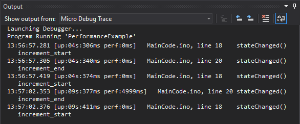

Example of Performance Output:
Video of Teensy Install + Basic Serial Debugging in Action
Video of @Plot Charts with Serial Debugger (works the same on Teensy)

It's a good question. We support both the injected serial (or software serial) debugger described in this post and also hardware debuggers.
Both types of debuggers have advantages and disadvantages. Without hardware debug users either add their own serial debug statements throughout their code and/or they can use the Visual Micro break/trace points. The number of break/trace points is limited only by mcu memory and do not change the real code.
Manually adding serial statements to track min/max values, monitor the millis() between code points, update variable values at runtime can be tedious, therefore Visual Micro adds the same (or similar) serial statements, based on the configuration of each breakpoint. Debug message strings remain on the pc which can often end up consuming less memory than large serial.print diagnostics messages in the code.
Injecting code into the temporary build files prior to compile works quite well for Arduino projects because, as you will know, the the build always happens in a hidden temp folder. This is because the .ino code needs to be merged into .cpp. The use of the temp folder gives perfect opportunity to inject code when in debug mode.
To ensure this solution works with all Arduino board types, Visual Micro injects standard Arduino code such as Serial.read(), Serial.print() based on the user configured debug settings. All of the code produced by Visual Micro can be seen in the temp build folder after compliation. tip: The temp build folder is displayed in the build output when "vMicro>Compiler>Show build folder" or "Compile>Verbose" is enabled.
Breakpoint properties such as {@plot} simply add the value (or expression result) to a delimited serial.print() prefixed by a breakpoint id (such as #1) The pc knows what to do with the data in terms of displaying messages, watches, plots or pin maps.
