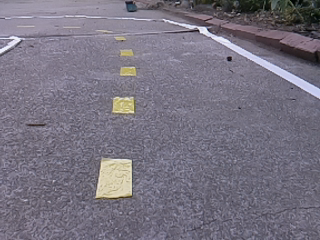

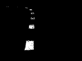

The vision on the bot is done through a Raspberry Pi and camera, whereas all of the real-time control (anything from power management to talking to motor controllers and serial bus servos) is done through a Teensy 3.2.
The code can be found here: https://github.com/jwatte/moneypit_v_for_victory
Some pictures:
