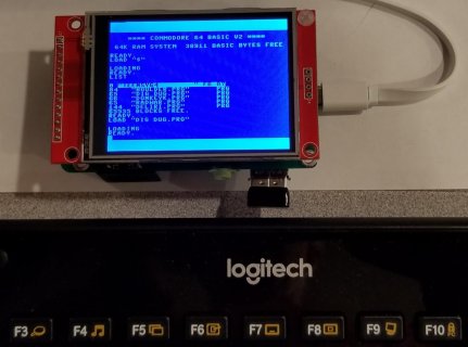

  • Simple drive emulation included (load "whatever.prg" or load "$" )
  • Supports original joysticks
  • very small
  • Hotkeys (e.g. "LOAD "$":LIST)

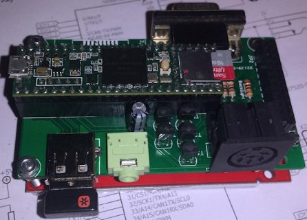

(Old Version of board with only one joystick port soldered)
The board is exactly the size of the display.

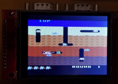

Working Games:
  • Boulder Dash
  • Bruce Lee
  • Choplifter
  • Commando
  • Commando 95
  • Fort Apocalypse
  • Frogs
  • GORF
  • Galaga (b&w version)
  • Galaxian
  • Dig Dug
  • Donkey Kong

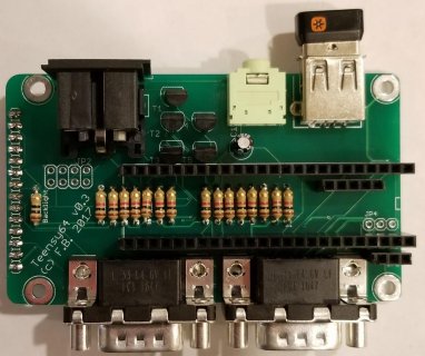

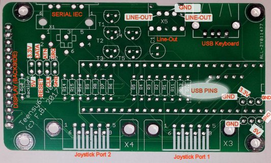

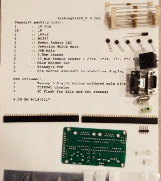

How to build:

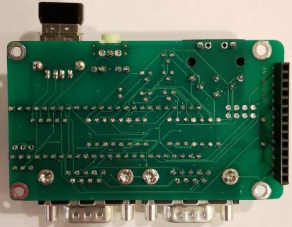

Use a good, clean soldering iron with not too much Watt (power) - 30 Watt are ok. Don't solder longer than a few seconds per soldering joint - if you need too, let it cool down and try again.
Solder the lowest/smallest parts first. First, the backlight-resistor, then the other 15 resistors. After that, the audio-connector and USB - then the pinheaders (Don't forget the USB-Host pins for the Teensy), transitors and the capacitor.
You'll need a small side cutter to shorten the female pinheaders - make sure not to cut too much by mistake! Don't worry if you loose one pin - that's normal.
Last step: solder the big Joystick-connectors and the IEC connector.
Double/tripple check if everything is ok, remove tin solder rests and clean the board. If you have a magnifying glass, please check that there are no unintended shorts or cold joints.
Don't forget to solder the USB Pins to your Teensy 3.6
Also, please take a look here: https://www.pjrc.com/soldering-pins-on-to-your-teensy/
Board looks nice!
And you can soon get one Kurt, work with Frank ;) PCB's and most parts to build 10 of them on there way to me - and I'll place a DigiKey order tomorrow to complete the kits for US addresses.
Easy to assemble and it works!
