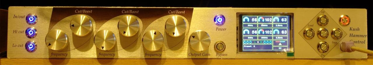

Here's my teensy 3.2 based midi controller, with a pdf description, and the sketch. The sketch is zipped, as there are numerous .ino files because I spread the sketch out across multiple tabs. Hope you find it at least interesting.

Thanks for this. I'm a complete newbie (well, I briefly used an Arduino 10 years ago at uni) and pondering putting together a controller for a SSL type EQ plugins.
The way you've packaged together your thinking like this is really handy. Cheers.

Hmm, that's an awful lot of errors from the libraries - all those "not declared in this scope" makes me suspect a library error. I'd suggest commenting out the #includes for the libraries giving the problems, and then include them again from the sketch tab - could possibly be a location reference, with the compiler not finding the library. Otherwise, I can only guess that the ili9341 library I used is not compatible with your setup as it is, so maybe take a look at the settings in the ILI9341_due_config.h file. I use arduino 1.66, as I've had some difficulties before with some libraries not working with some builds, which can be very frustrating. The main reason I used this library over any other ili library was the very clear documentation for text alignment and its arc function, that I used for the gauges.
So, I did a very quick and dirty edit of the sketch to use the ILI9341t_3 library instead, just stripping out all the arcs, fonts and text formatting - some of the library commands are different, so a little bit fiddly, but this library does at least drive the display, and is optimised for the teensy, so should work with any build. I'll post a copy if you like, just so you get something that'll hopefully compile, but it's incomplete proof of concept thing and I haven't prettified it - so, most of the graphics aren't there and for example, the text will overwrite itself, that kind of thing. However, if there are any component parts of this project that you'd like explained more, just let me know and I'll knock up a more simplified sketch to cover them - I guess this project does jump about quite a bit. Most of the ideas are simple enough, but would breakdown sketches such as eg

The MIDI errors look like the library isn't right, either - my #include was the contributed library from the arduino installation, so can't see any reason why that shouldn't work. I only added this library to have a 5 pin MIDI port on the tx/rx in addition to usb, so its not really required at all - the usbMIDI just works class compliant if the tools/usb type is set to MIDI. Hardware midi should be fairly straightforwards, just needs

Why are you using ILI9341_due.h when you're compiling for Teensy 3.5? That looks like the code for Arduino Due.
Normally you'd use ILI9341_t3, which is the one optimized for Teensy.

Hello there - I guess that's down to me. As I mentioned in post above, the main reason I used the due library was for the additional text formatting, and the simple to use fill arc functions - there are no arcs in the 9341_t3 library, or the adafruit gfx that I could see. I'm just learning as I'm playing around and exploring, and I'm more than happy to acknowledge that there are more elegant and efficient ways of doing things - I just found that the library documentation for the due library was very easy to follow, and it compiled and worked well on my teensy 3.2. This is my first functional project with any complexity, and to be honest, I was pleased to get it to work as intended:)
