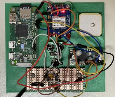

This uses a Teensy 3.2 and its FTM to precisely measure the frequency of the AC power line. An external GPS provides a 1 pps calibration pulse to continuously calibrate the Teensy's 48 MHz clock. Data is logged via a Raspberry Pi 0 W. A 9 V AC adapter powers the system and also provides the 60 Hz signal which is measured.
This project uses multiple FTM channels -- one for the 60 Hz, and one for the 1 pps calibration.
The Teensy's comparator and DAC are used to sense the 60 Hz signal. The comparator provides a clean output, and its hysteresis prevents false signals. Data is transmitted via the Teensy's USB serial (if connected), and to the R Pi's serial port for it to log via WiFi. A tri-color LED is also provides pulses for a visual indication of correct operation.
For simplicity and debugging, all modules are mounted on a 3-D printed base with brass inserts to hold the GPS and R Pi boards. A small perf. board holds the R.C filter for the raw 60 Hz AC signal.
The system is very accurate (synchronized to GPS 1 pps which is +/- 20 ns) and has high resolution -- it is easy to see 0.0001 Hz frequency shifts which continually occur. The R Pi logging also prints a simple strip chart. An example of logged output is:

2022-02-01 19:11:51.738 #
2022-02-01 19:11:51.738 # Ticks, Cycles, Frequency, FBUS, Total Cyc, Flt, Phase, 1Hz
