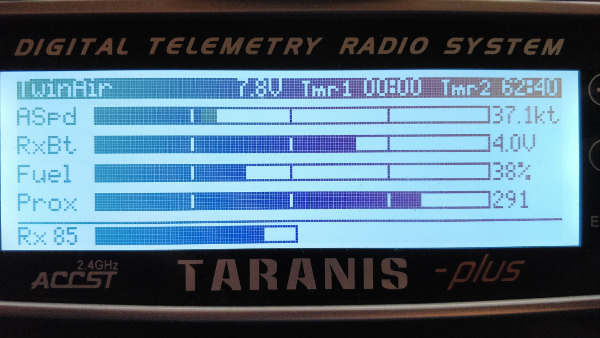

Example of telemetry data displayed on the receiver
Prox - millimetres from the ground

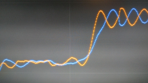

Prop Synchro PID loop
Here are two examples (taken from the datalogger) of the PID loop back in 2017 when it was somewhat more "un-tuned" than it currently is today!
