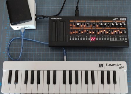

I wanted to play my MIDI hardware synths with a cheap small portable MIDI USB keyboard.
There are a few MIDI USB Host converters on the market, but they tend to be pricey and not so flexible; for example, the MIDItech USB Host converter I purchased (at $80+ ) does not filter "Keep Alive" MIDI messages, which cause issues with many older MIDI synth modules. Moreover, when you connect some MIDI USB keyboards, they send spurious junk over MIDI for the first second or so, again causing issues to some hardware modules.
So this is it: a converter powered by the phenomenal Teensy 3.6. I did not need processing power and wanted to save battery, so I downlocked it to 24 MHz, more than enough.

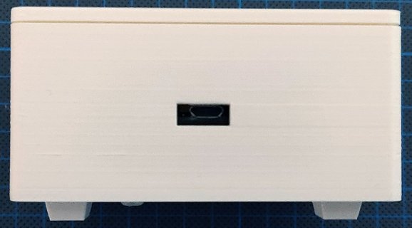

Connected to a smartphone USB powerbank, it runs for many hours while powering the USB keyboard.
Thanks to my dear friend Alessandro for the soldering work and the 3D printed case.
For the hardware part, I just followed the instructions on PJRC website:
https://www.pjrc.com/teensy/td_libs_MIDI.html

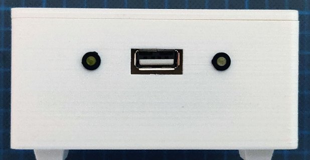

Added a couple LEDs to signal errors and MIDI connection
Software is not really complete, but works OK for my limited needs:
I'm infinitely grateful to PJRC and all of PJRC Forum members.
Thanks guys!
