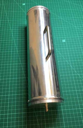

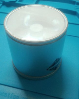

the 63x63mm NaI(Tl) probe (aluminum tube) is on the left side connected with BNC cable. Test vintage radium watch from 1960...
