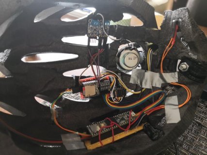

I chose Teensy 3.5 because of the incredible power of the mc (120MHz!) and a math coprocessor.
Active head tracking requires a lot of float match to be performed repeatedly and very very quickly to keep the quaternions updated.
Teensy does the job beatifully and is the central brain of the costume animatronics.
