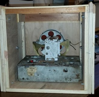

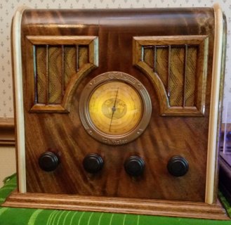

I helped a friend "restore" a 1938 Zenith floor-standing radio, changing it into an MP3 player. We collected old radio broadcasts ("Whistler", "Shadow", "Grand Ole Opry", "Burns and Allen", "War of the Worlds", etc) and separated the content into folders. I use a Teensy to read the capacitance of the tuner to select a folder on the SD card, then randomly choose an MP3 file to play within that folder. I use the audio library to inject hiss in between "stations" and other special effects.

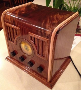

The project turned out so well that I wanted one for myself, but much smaller. I purchased a beat-up RCA 118 radio ( https://radioatticarchives.com/radio.htm?radio=11343 ) and had my friend build a new case. We chopped down the chassis so the entire radio is about a 12" cube. I use one band for the old historical programs and another for modern music. On the modern-music band I have one "station" that is random-play across everything in the band.

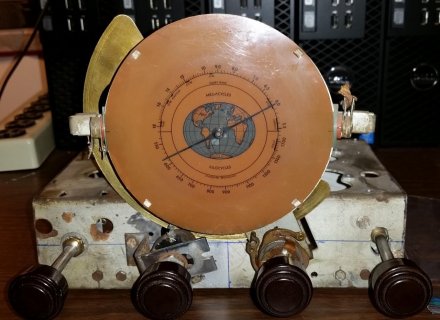

Cut-down chassis
Chassis in new case
New electronics
Completed "radio"

First knob on the left is power/volume control.
Next knob is the band selector (two bands, as indicated on the dial. Top arch is one band, bottom arch is the other.
Next knob is tuning.
The Knob on the right was tone control on the original RCA 118. It is now a forward/back "bump" button to select a different MP3 file.

The small perfboard hot-glued to the back of the dial has two orange LEDs. I use them as a tuning indicator. When both are off your're centered on a station. As the tuning drifts, one LED gets brighter indicating the direction to turn the dial. The brightness of the LED also indicates how much hiss is being added to the audio.
