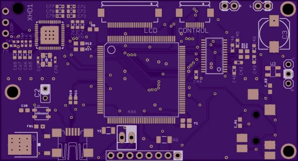

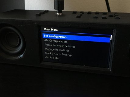

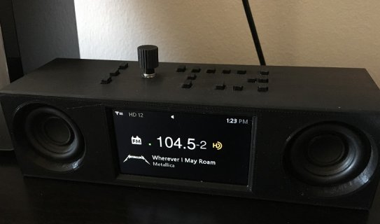

I am working on an almost complete digital radio (HD Radio). I have the hardware design already completed, but now working on the HD radio functionality aspect of the project. As you may or may not know HD radio only applies to North America, but RDS is working perfectly too. I will be able to release more information as I near the completion. 180 Mhz of the Teensy 3.6 is awesome!
Features:
FM / AM Radio
HD Radio + Artist Experience (Album Art and Station Logos)
Stereo Recording of Radio Program (WAV files, 16bit - 44.1k)
Alarm Clock
Stereo Audio + Digital Audio over USB connection
IPS Display (super viewing angles)
Great Audio - PCM5122 DAC

I also plan to make a portable version with the same functionality, but I have no clue on how to add a charging circuit / battery to the whole mix:
I able able to draw very low current using the Snooze library, so standyby time should be great, and the whole circuit draws about 150mA when running with earphones plugged.
