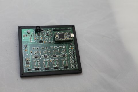

Working with a senior instrumentation specialist, we have implemented a USB DAQ module using the Teensy 3.2, with analog circuits designed around the electrical characteristics of the Teensy ADCs and DAC. There is also a precision current amplifier that we designed to pair with the board, and the system with software, provides measurement into the pA and pF ranges. The control software is written in Python and provides a GUI and CLI.
I have been using the system to characterize OLEDS and measure detailed electrical effects of surface contamination. In these studies I routinely clock the two ADCs and DAC together, at 200 kHz without data loss.
If anyone is interested, please let me know. I am planning to make some extra copies of the boards.

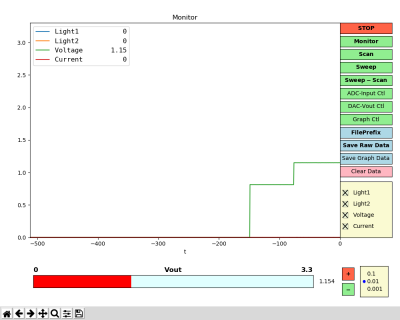

I am indeed willing to share. This is a screen shot of the python GUI that we use for testing our solid state lighting devices. You'll notice that it is pretty quiet, even though I just now ran it with the unshielded board sitting on my desk with open inputs except for the wire patching the DAC output to the input labeled Voltage.
The data is output as floating point or binary values to a column formatted ASCII file.
The gui runs alongside a console CLI, so that you can enter commands or click buttons and see the interaction between the program and the Teensy DAQ. There is also a stand-alone CLI program.
There is a help command that lists and briefly explains the complete command set for the firmware along with commands recognized in the CLI.
The CLI (no graphic) and the GUI programs, can take commands from stdin and write to stdout, and provide syntax to string commands together, sleep, wait, and pipe or tee to a file. I have automated a lot of my data acquisition procedures using bash to feed commands into the CLI or GUI.

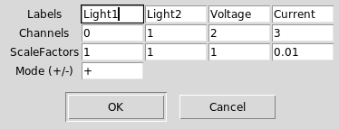

Here is the Analog input control dialogue. Notice that it has settings for labels, scale, and differential or single ended input (this is controlled by a digital i/o pin). The number of channels is set in CLI or cfg file. There are four input circuits on the TDAQ board, and I have external boards that add more channels,

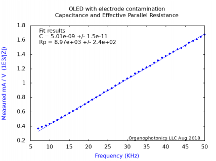

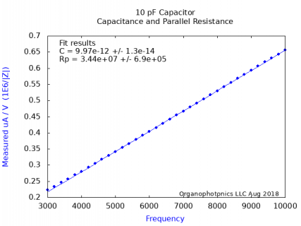

Here is a capacitance measurement, it was made by measuring amplitudes as a function of frequency. The parallel resistance refers to leakage current.
In addition to the conventiional DAQ functions (read voltage, set voltage, set/read pin, etc) the firmware also has tone and frequency sweep functions that can use the two ADC's together.
In this instance, the frequency sweep was run at a clock rate of 200 kS/s per ADC, at 16 bits, and with a command switch that causes it to return an amplitude for each of the two channels at each tone frequency. The firmware uses a Goertzel to extract amplitude and phase.
And here is a measurement for a solid state lighting device that we are studying. It has a large capacitance and more leakage current.

In fact, the noise that I reported for our design in #6 above (0.05 mv to 0.08 mv), does not change when I run other interfaces at the same time. It stays in the 10^-5V range.
In the picture in #1 above, you see that this is a surface mount board. I'll expand on that a little bit to note that we spent about three months on the design, including optimal component selections, detailed circuit analysis and optimal board design. The low noise figure did not just happen, we worked for it.
