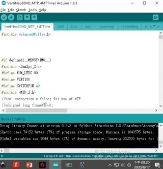

It is programmed with Arduino 1.83 and Teensy 1.38 , with many library modified for some purpose. The PCBs were designed with Fritzing.

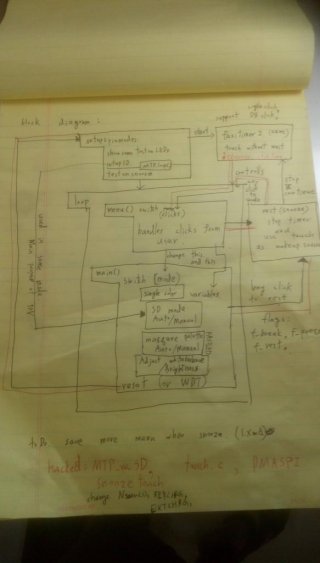

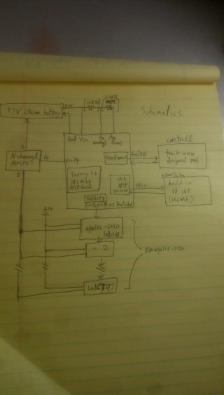

Schematics & code diagram:
schematics.jpg schematics like mentioned at features above, see the hand-writing.
Specific pins used in features:
Battery power measuring : A4(set as gnd), A5(analog Reader) : using internal reference, and with a 2.2K&10K to divide voltage level.
N-channel MOSFET gate: pin 14(A0)
DMASPI to apa102 chains: pin 11&13 (Dout and Clock of hardware SPI)
Touch-sense: pin 23(A9)
diagram.jpg Diagrams of code
Setup:
pinMode // set them to what they had to.
setupthings // such as SD,Flexitimer2 so clicks start working
showsomeLEDtest // so that’s easy to sure hardware is fine
testonsnooze // to check with hibernate.
MTP.loop() // if USB connection is present, loop this loop
breaks with DB-click Or just skip if not,
loop:{
Menu(): { this is the most important handler to let user able to switch between modes, and change variables via DB-clicks/multi-clicks.
Mainswitchcase() { do the modes-function like mentioned above.
Rest() { stops the flexitimer2, pull-down the N-MOSFET gate, SPI port and anything the drains mana, and hibernate with snooze, wake with A single touch and resume power supply and flexitimer2.
Flexitimer ISR: {
Every 25ms this is called to check if the touch-pad(or button) was clicked, deal with the results and launch the next touchread(but don’t wait ).
Sets break flags if situation met.

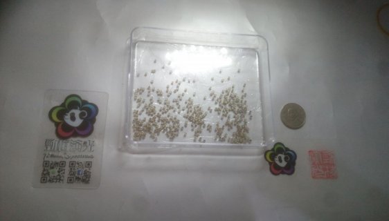

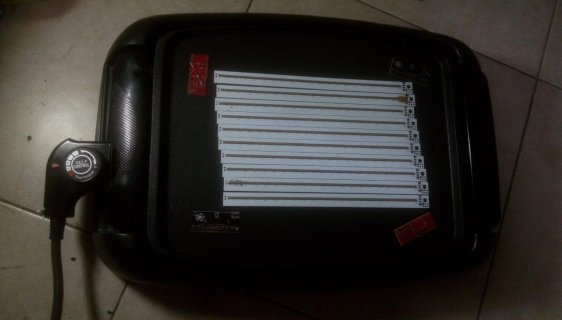

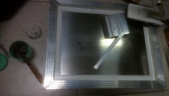

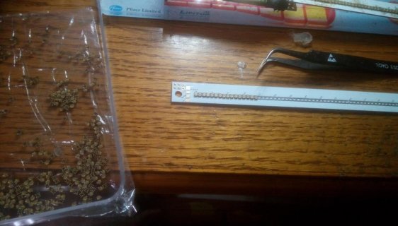

apa102-2020.jpg1. prepare LEDs
stencil.jpg2. Stencil and apply solder paste
paste&place.jpg3. put those tiny LEDs with tweezers
cook .jpg4. cook them!
5. clean up excess solder and all short/bridges
Due to the expensive of materials, and personal project was such small amount not appropriate for automatic-smt.
one of the major challenge of this project falls on apa102-2020 hand-soldered with stencil /paste,
needs hot-air and iron repair afterwards, so many shorts a board of 80 Leds took ~2 hours, however they did work after cleaning,
that gives hope to my long torture of cleaning up.:p

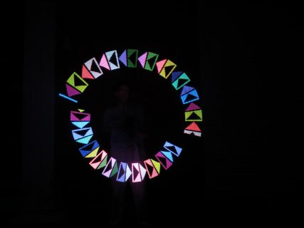

tree under sky.jpg"tree by dawn" some picture actually need to be adjusted on PC, for gamma correction
settingb.jpg a "bmp" with "settingB.txt" to show the "page" you're in
runez.jpg colorful runes
this two are marquee mode, with arrow/triangle figures, they are not the 80HD POV but 36HD POV instead,
however the marquee display functions are mostly the same
and I forgot to took photo with marquee mode with 80HD :(

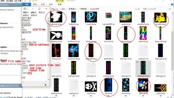

Some extras
Here are some more about how I setup the details of a perform-project.
the red circles are pictures that tooked photo at comments above,
mostly with ~1/4 shuttle, aperture of 8.0 , and a flash on to capture the player.
Left is one of the "settings.txt", the text filename and all variable of it is defined by my code. It is the core file in SD.
if any of the settings (frame-speed, repeat times) is 0, then it is unlimited.

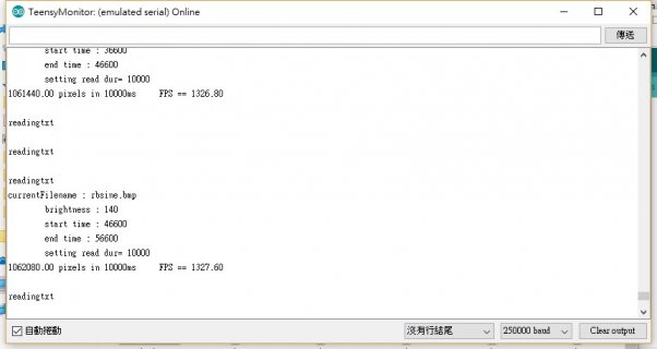

use the serial monitor for debug and see the exact frame speed (or row speed)
the fastest here by far is ~1425 FPS, @192Mhz , FPS of other clock settings are:
~1327 @240Mhz, ~1194@216Mhz, ~1325 @ 80Mhz, ~1236 @168Mhz, ~1420 @144Mhz,
~1320 @120Mhz, ~1416 @96Mhz, ~1281 @72, ~1397 @ 48Mhz, ~1280@24Mhz
I don't have a clear idea about why, but if 50Mhz > (Mhz/2^n) > 40Mhz than its probably fast, this case 192Mhz/4 yield a 48Mhz.
Should have something to do with SDIO clocks. I'm suprised by the speed@24Mhz, clearly the storage-device is most speed-determining.
at 192Mhz , different cards may have different speed, ranged from 1100 to ~1450 FPS.
above 1000 is pretty enough, but pictures may need adjust on PC for better POV effect.

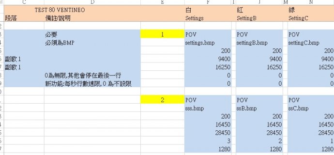

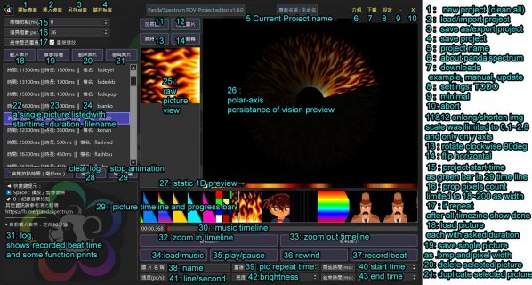

Absolute timing(to ms) was used to follow a music, I use Audacity to get the absolute timing of a music,
And excel for easier manage to multi-pages, comments and cleaner views.
If you wish to see the project files used in a PC, here's a zip of the example project, with 7 pages and 7 pictures used per page,
note that there is no limit to picture per page, but there are only 7 pages as I coded to. :)
https://drive.google.com/open?id=19-waVrGo7ohmufluRxPrfQ8ore51o00W

Just out of curiosity about how fast is pure-SPI can do,
and found that with SPI but not DMASPI it has ~1520FPS @192Mhz
turns out that I forgot to set the clock of my DMASPI so it's using default settings:(:(:
with correct settings it uses 16Mhz for DMASPI , ~1830FPS @240Mhz,180Mhz---96Mhz, ~1700@72Mhz,
(16Mhz has a approx. 6000FPS maximum from my calculation of 32bit/per pixel *80leds)
later I test different microSDs,
and the difference between cards became much bigger(1200~2800FPS)
1200FPS from a 128MB card, 1800 from 256MB card, and 2600 from SANDISK 8/16GB (class4), 2700 from 32GD SANDISK (class4)
(the 128/256 card's from alibaba and speed varies each card)
way more than enough.
with this speed maybe 160HD or 200HD is reachable with good POV effect.

First my codes,
should need to use some my specific libraries,
(though if I remember correctly, the same library with 1.8.7 compiles too)
this was the full folder of my used version and libraries,
and this was the .rar of my code when the post was published.
it should work(compile) with teensy 3.6, 180Mhz and with MTP selected
see the screenshot, tested, still can successfully compile
Recent update:
I had some luck learning python and have some experience on using it on 2024,
and with the progress of some AI coding, I decided it's time to go for a GUI.
so after June and ~1 month of progress I've made the, with python on Visual Studio Code,
available on windows and MacOS. I don't have many users using my POV product but his is always one of the pieces I wish to accomplish.
MacOS: https://drive.google.com/file/d/1WwyQu8xGVpty0tPY0y9Ngz554AFjodqi/view
Windows: https://drive.google.com/file/d/1rPrk8-xjZ8laXGsDgjGl4NtUxZ_GWWKK/view
screenshot as attachment:

I'm currently trying to solder the LED boards and I'm consistently ending up with VCC-GND shorts after reflow. I'm planning to order a new stencil with reduced apertures and thinner steel to get less paste, but some shorts will probably still happen.
I have a couple of questions if you don't mind:
How did you actually locate the shorts?
My idea is to use a current-limited PSU and then feel for LEDs that are getting warm but I'm not sure if that's a good approach for so many LEDs
How did you fix the shorted LEDs?
Did you remove the excess paste or reapply a small amount manually without a stencil?
Thanks!
Hi, I currently don't solder the 2020 LEDs myself anymore, I order from internet PCBA...
mostly I encounter data/clk pin shorts to Vcc or gnd, which is obvious as I can see the LEDs aren't updating after a specific LED, just check the pins nearby and typically short could be found
However if you have trouble,
Examine your board under sufficient light and magnifying glass if needed,
if some shorts under LED and pads, heating the board nearby could help solve it,
or using some solder helping paste ( not sure what that called, not containing solder or tin but just helpful oil to help flow the oxidized solder)
and heat with ion and slide/push the target LED with a tweezer a bit and return it to the origin location.
the redistribution of the excess solder could solve it's own, because pads under 2020 typically not too big and not too much solder.
you have to be careful not to shake otherwise LEDs could fall off the board
Give up boards too hard to repair is also an option, they cost much but your time and labor matters more.
Good luck!
