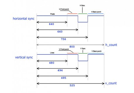

I have then test on STM32 for try to shift the screen to right , i don't have reproduce the same as we have on the teensy but it come from the H back porch + H Sync + H Front porch , when i set them to wrong value the picture move too :eek:
If it's possible , can you try this on your timing ?
This timing made me a perfect 640 x 480 screen with no shifting , now for the 640 x 400 the horizontal timing stay the same , only the vertical one change because they are less line to show.
Cheers.
According to your drawing,
back_porch = 800-756= 44
and front_porch = 660-640 = 20
So in the lib do:
#define frontporch_pix 20 //16
#define backporch_pix 44 //48
Does it resolve your problem?
Regards,
J-M

Hello Jean Marc :)
I'm back home and tested what you say , it change nothing for the drift to right.
It's not just on emulator but generic , it do also the same with the demo program.
I don't remember what we do in the pas to recenter the picture .....
Cheers.

Not sure what is wrong with your monitor.
I had updated the code the last w-e with the reduced values of the back porch.
I tested on the 3 monitors I have here. They have an auto adjust option so I never have this shifting issue.
I also added a mechanism to allow pixel shift between upper and lower nibble of the 2 DMA copy (in copyline mode only)
That allows to compensate the delay between 2 DMA channels but I noticed that the delay is not constant so it does not really help to resolve the sharpness.
