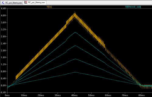

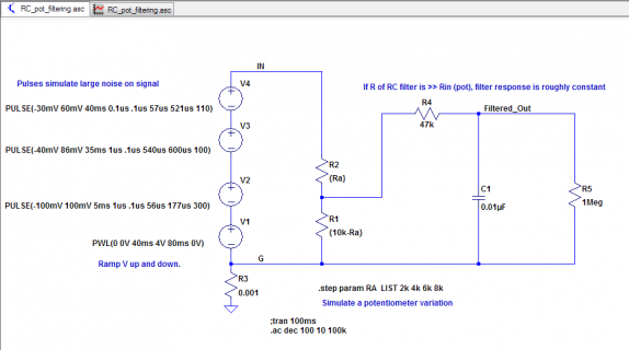

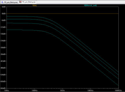

In response to oddson and others wanting to filter a potentiometer. From the hardware side of things... to avoid having the potentiometer position affect the low-pass filter response, there needs to be another resistor that defines the filter and acts as a buffer. In short it needs to be much more than the variable resistance that precedes it.
For this application with a typical potentiometer of 10k, roughly 5x more or around 50k works well enough. I've attached a circuit, and a plot of the time response of a 'noisy' signal added to an increase and decrease of the potentiometer value. The frequency response plot shows that the cutoff frequency Fc remains constant at ~700Hz. (The four lines are for different values of the potentiometer.) You can see that large noise pulses with sharp edges are knocked down pretty well without noticeably delaying the response.

Thanks for this detailed example. I'm just learning LTSpice and this showed me many techniques I hadn't realized.

In response to oddson and others wanting to filter a potentiometer. From the hardware side of things... to avoid having the potentiometer position affect the low-pass filter response, there needs to be another resistor ...
Thank you... that was my point... There are a lot of places on the web that suggest putting a cap between the wiper and ground... I think it's guitarists used to tone controls. :p
