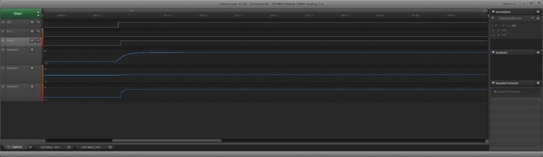

Any chance you can get access to an oscilloscope (and someone with the experience to use it) so you could capture the start-up behavior of the power supply? Capturing what's happening on Teensy's 3.3V power and maybe even the reset signal (if the scope has more than 2 channels) might be useful.
Sure, I will do that later today or early tomorrow morning. I already had turned up the power to the Teensy to 5.7 VDC but if there was a change it was not anything noticeable.
Paul, not sure how much the logic analyzer output helps. Note Currently using my Logic 8 and not my Logic Pro 8, on the off chance there looked like there is some bad voltage and if I were screw one up, prefer to screw up the cheaper one :D
Here is logic output for T36 again with VIN, D13 and reset, with both Analog and digital.
But as it looks like voltage are not out of range, if it would help, I can get faster resolution with the PRO if that would help. Note: I left it plugged in and finally started blinking a few minutes later.
Just in case it helps. I hooked up Pro. Here is showing that area. again... It is interesting looking at the voltages ramping up.

Well, that's a pretty nasty looking power supply startup, as it crosses between 1 to 2 volts.
Is this buck converter and isolation converter a product I can buy somewhere? Or if it's something you've made, is there any chance you can send me one?
Edit: my gut feeling, from only these words and that waveform, is one or both of those converters may be suffering from inadequate capacitance at their inputs. The capacitor ESR matters greatly, sometimes even moreso than the actual capacitance. So do the design details like switching frequency, the converter's circuit topology, and so on. But this is just a guess, or a hunch really, based on prior (painful) experiences with other switching power supplies.
