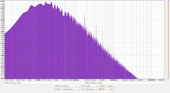

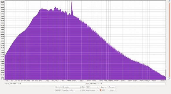

I'm trying to avoid having the uSD card writing draw too much current and impacting a microphone.
