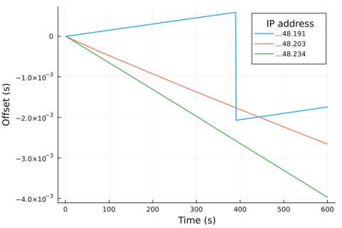

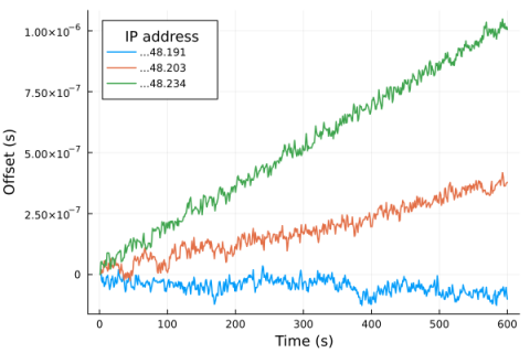

By way of an update, should it interest anyone, teensy-ntp led me to an NXP application note on IEEE 1588, which in turn led me to a conference paper by a team from Hannover, who forked qnethernet, implementing the ENET timer registers, and a github repository with a PTP implementation. I forked that repository, exposing the nsps adjust value, and applied it as a proportion to the audio sampling rate. I also wrote a sort of hardware abstraction layer so I could better understand how to work with the audio subsystem at a low level; sampling rate conditioning is one thing, syncing DMA interrupts is another, and took some trial and error. It's a messy, undocumented work in progress, but I have something that supports sample-synchronous output across a network of Teensy 4.1s, give or take a couple of ppb remaining drift that I'd like to fix at some point. Here are some plots of before and after PTP-based audio clock conditioning; I played back a 1 Hz pulse on one Teensy, and also sent it to a UDP multicast group, read and played it back on three other Teensies, and measured the rising-edge offsets.
Before:
After:
(Audio client .48.191 falls far enough behind that its ring buffer wraps around in the unconditioned case.)
Supporting the system is a reasonably-priced managed switch. For the measurements above I was using linuxptp and a PTP ethernet dongle, but since it doesn't matter to me whether all the PTP devices think it's 1970, and since I found that using phc2sys to condition the system clock to follow the PTP clock didn't achieve a good sync (probably because the former is a software clock) more recently I've been running one Teensy as a USB audio device, governing audio time for the general purpose machine, and also as a PTP authority for the rest of the Teensies. I wanted to run at 48 kHz (not least because a sampling rate that's a multiple of the buffer size makes syncing audio interrupts a lot easier) so I created a modified teensy4 core, with changes to usb_desc.h, etc. setting a different USB feedback accumulator and increasing AUDIO_TX_SIZE and AUDIO_RX_SIZE.
