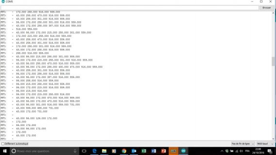

I'm trying a simple code in order to identifie in real time the predominant frequency in a complexe sound. In a FOR loop, I compare each FFT value at each 43Hz to get at the end of the loop the highest value and then print it in the monitor.
So if I simply ask it to print the value each time it gets a new higher value while being in one step of the loop, the code works and I get in the monitor in each line all the highest frequencies in the sample with the highest one at the end of the line. So for each sample I will get 0 (initiale value in HZ) then 43 (first test) and then some other frequencies that the code founds in the FFT higher than the 43HZ value. I compare the value of the FFT but I print the frequency that correspond to the value.
But I would like only to get the highest value of the sample and print it at the end of the FOR loop. So I tried the program below and it doesn't work (I've put in red my modifications). The monitor only gives "FFT : -" on each line as if the "c" value I test in the code always got to the initial value "0"... I don't understand why. Could someone help me please? :) thx!
