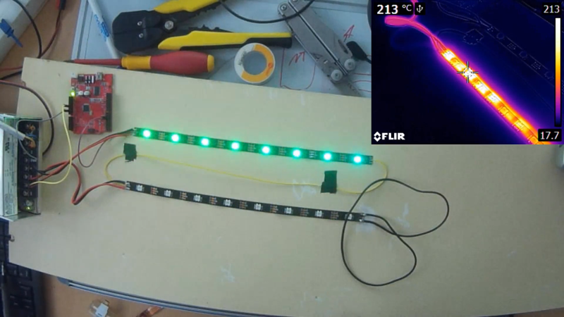

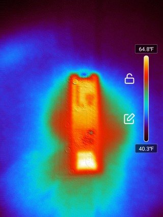

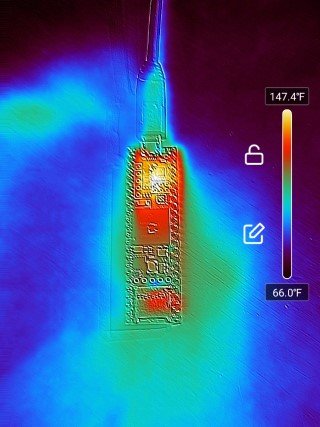

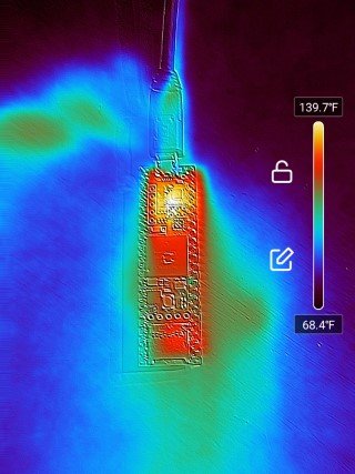

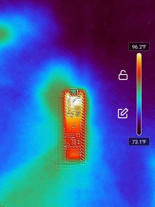

so my ongoing months long TRON light cycle project was just about to debut today after getting the overt COB lighting all set up. last night i started connecting the WS2815 12V LED strips that i've buried in the under glow of my motorcycle after finally getting my programming solid and building a host circuit board.
but now, after making only one connection, i get nothing.
well... nothing except heat.
the board gains in temperature really quickly when plugged in.
now the questions are:
how fried is the board?
is it (user) repairable?
and...
should i put some diodes (i could use suggestions) on the data pins i'm using to keep this from happening again?
board is 4.1.
(thermal camera views are attached.)

i have isolated it to a series of parallel strips and i'm wondering if a level shifter would prevent this?
Nobody is going to be able to say, without any information about how anything is being connected.
well...
i feel that if i'm making references to a 12V system and asking about level shifting that maybe some inferences could be made, but ok.
the 12V is direct to the strips and does not make contact with the Teensy.
the Teensy is being powered off USB 5V.
and the LEDs are raw dogging to pins 1, 8, 14, 17, 20, and 24, through terminal blocks on a prototyping board.
the first board was fried with the same WS2815 LED strips and i have Ohmed those out to be reasonably sure that there isn't a short. that said, it is possible that there is a problem there that i am not able to discover with just a meter.
Protecting against higher voltage usually involves a resistor and a diode. The diode limits voltage by directing current flow caused by the excess voltage. The resistor limits the amount of excess current the voltage can cause, which makes the diode's job possible.
Here's one way you might try.
In this scheme you would have 2 stages of protection. R2 and the zener diode are the first line of defense. For example, if you choose 470 ohms and 5.1V zener, you could expect about 7mA to flow through the resistor and into the diode which hopefully holds the voltage to around 5 volts.
If R1 is also 470 ohms, more current will flow through it and the tiny ESD protection diode inside the chip, to the 3.3V power line. Those diodes are very small and can only handle low current, maybe 10mA. As long as this current is less than the total power consumed from 3.3V, the effect will simply be the lessen the amount of power drawn from the 3.3V power supply. But careful attention to the worse case is needed, because if more current flows than the 3.3V power consumption, then it pulls up the voltage of the 3.3V power line, putting everything at risk. The diode will also have a forward drop around 0.6 to 0.7 volts, so the pin could be subjected to 3.9V to 4.0V. Not great, but likely to survive. Let's imagine the zener diode actually allows 5.5V (typically zeners aren't very accurate) and the pin ends up with 3.9V. That's 1.6V across 470 ohms, which is 3.4mA additional current which flows into the pin and through the ESD diode inside the chip.
Those ESD diodes come into play when the pin isn't configured or is acting as an input. When it's an output, 1 of the 2 transitors inside the chip connects the pin to either 3.3V or GND and effectively acts like a resistor in the 20-50 ohms range. More current can flow through R1, but the good news is those transitors are able to handle current better than the ESD diodes.
You can get better protection with higher value resistors that limit the current to lower levels, and with a better quality zener diode that clamps at a lower voltage so the 1st stage (with R2) does all the heavy lifting and 2nd stage (with R1) which depends on tiny ESD diodes and transistors inside the chip puts less stress on the chip.
Of course the downside to higher resistors is your signal output becomes "weaker" due to the higher impedance. The same effect of limiting the current that can flow in during accidental connection to 12V also limits the current that can flow in/out when you wish to drive a signal onto the LED strip's input. There's no perfect answer, only trade-offs.
While this sort of circuit does allow some stress on the chip during an accidental fault to 12 volts, if the parts are well chosen usually the chip will survive that stress.
