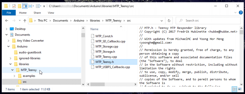

Your programs/sketches (whatever you wish to call them) are stored in the directory C:\Users\iandi\Documents\Arduino\.
Libraries, which is what MTP_Teensy is, are stored in a directory called Libraries within the above directory...so C:\Users\iandi\Documents\Arduino\Libraries\.
Having downloaded the MTP_Teensy file, you will see that it is a .zip file.
Fortunately with Windows you can double click on that .zip file and copy thee contents to the Arduino Library directory.
You can this by above by DOUBLE CLICKING on the MTP_Teensy-main.zip file.
Now RIGHT CLICK on MTP_Teensy-main and select Copy from the menu.
Now move to C:\Users\iandi\Documents\Arduino\Libraries\ and RIGHT CLICK on some WHITE SPACE and select Paste from the menu.
Now the MTP_Teensy library will be in the C:\Users\iandi\Documents\Arduino\Libraries\ directory.
If you find MTP_Teensy inside a "libraries" folder, don't make the mistake of dragging that libraries onto the libraries inside Documents/Arduino. Doing so will result a libraries folder inside the libraries folder. In other words, you would end up with C:\Users\iandi\Documents\Arduino\libraries\libraries\MTP_Teensy. Arduino will get confused, because every folder inside libraries is supposed to be an actual library, not another libraries folder with more libraries folders inside it. The final result should look like C:\Users\iandi\Documents\Arduino\libraries\MTP_Teensy.
So it should look something like this (click on the image to enlarge it...):

Looks like you copied everything that was inside the original MTP_Teensy folder to the Documents/Arduino/libraries folder. But you should have copied the MTP_Teensy folder (with all of its contents) to Documents/Arduino/libraries.
To recover, delete all that stuff you copied over. Then try again. Drag the MTP_Teensy folder over, so inside Documents/Arduino/libraries you will see a single MTP_Teensy folder, and inside it has all this stuff.
Checking your screen against the image in msg #34 might also be a good way to make sure you got it right.

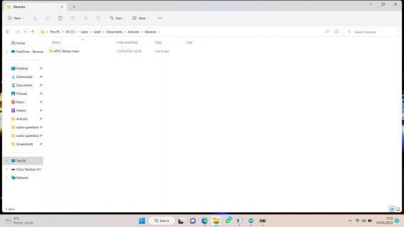

Probably OK ... hard to tell without seeing the full path to the folder and a glimpse of its contents. It doesn't need the -main on the end, but I think it doesn't hurt, either.
getting this now moved the files and folders like u said

Ok, look to see if the files play_sd_wav.h and play_sd_wav.cpp are in your audio-guestbook directory.
Oh dear, I have just compiled the copy I downloaded to my PC without any error.
Do you have this line in your code: #include "play_sd_wav.h" // local copy with fixes?
I have just commented it out on my copy and get exactly the same error as you are experiencing.
EDIT:
The line in question should be around line 31.
The code below is what the start of my program look like.

My post#38, second and third bullet points ... your posted code has been modified, though not actually in an important way (someone added a question mark after the line @BriComp highlighted). More important, it looks as if the carefully modified play_sd_wav.cpp and play_sd_wav.h are no longer in the sketch folder. It appears that Arduino somehow glosses over the loss of play_sd_wav.h, probably by including the file of the same name from the Audio library, but as a consequence can't find the definition for the AudioPlaySdWavX class.
Copy ALL THE FILES, but NOT the audio-guestbook directory and paste them INTO the audio-guestbook directory.
no error message now but gotta amplify it all as cant hear message or bleep and very quite on play back
Glad you got it to compile. I guess now you know how data and directories are arranged for programs/sketches and libraries.
How are you trying to listen to the sounds?
