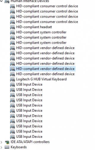

Hello every one , i am working on a DIY teensy 4.1 , i took the U2 : GD32E230F8V6 from an old teensy 4.1 that was fonctionel , but when i connect it i get this behaviour :
* the LED blinks 10 times then stop for a 4 seconds and repeat the cycle
* when i click program button the get the image of the micro controller in the programming tool ,
* when i connect the board the pc makes a sound and i see a new HID compliant vendor defined device showing .
does that mean my micro controller is broken ?
Can any one guide me please? thanks

This won't work. The U2 chip on a regular Teensy 4.1 is already pair with the U1 chip. It won't work with a different U1 chip.
thanks but its just sad , is there a way around this? and when does the pairing happen? is it the first time U1 talk to U2? do i need a fresh U2 to make it work?
My bad , i read that MKl02 must be paired , but i didnt think that if i put it in a knew system it will not repaire automaticaly .
So basicaly the U2 is one time use , what will happend if i had to change the flash at some point , does that mean i have to get a new U2?
Flash memory is not fused, so it can be replaced.
But the RT1062 and the MKL02 are fused together the first time they both power up.

The U2 chip that comes soldered to Teensy 4.0 or 4.1 is never meant to be used on a DIY circuit board. The T4 bootloader chip (IC_MKL02Z32_T4_QFN16) is meant for that DIY purpose.
If you desolder U2 from Teensy 4.1 and attempt to use it on a DIY circuit board, the behavior is undefined. It might work in some limited ways, but may not work. It may fail unexpectedly. It could literally do anything. Different U2 chips from different Teensy 4.1 boards might do different things, and chips taken from future Teensy 4.1 might behave in other ways. This is the nature of "undefined".
