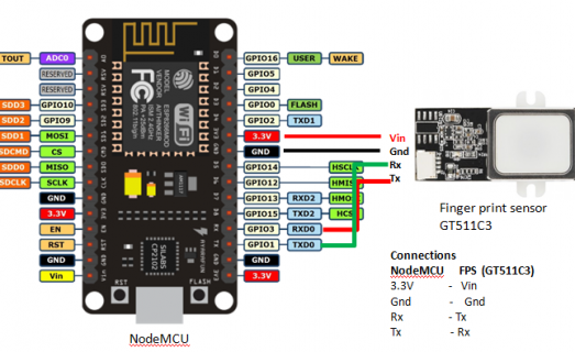

I used the hacked up version of the library (posting #10) but no luck. By the way, I am using NodeMCU 1.0 (from Espressif). Does your hacked up version work for NodeMCU too?

Dear KurtE,
Thanks for the quick reply.
Please find below the picture of the connections. Please let me know if I need to make any corrections.
That is not a picture of a Teensy board? So I have no idea. If you are not using a Teensy (PJRC), you should maybe ask as a forum that is geared around your processor board and/or one geared to your device.
But if you are using a Teensy, a picture of the actual setup would help... Often times diagrams like this miss what actually is setup.
