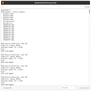

Serial.println("USB Tester, files present:");
if (!r) sd_error();
File rootdir = SD.open("/");
if (!rootdir) sd_error();
while (1) {
File f = rootdir.openNextFile();
if (!f) break;
Serial.print(" ");
Serial.println(f.name());
f.close();

bool identify_teensy_model(const char * &filename)
Serial.println("Identify Teensy Model");
elapsedMillis timeout = 0;
while (timeout < 250) {
uint8_t id = bootloader.id();
switch (id) {
case 0x00: break;
case 0x1B: filename = "TEENSY20.HEX"; return true;
case 0x1C: filename = "TEENSYPP.HEX"; return true;
case 0x1D: filename = "TEENSY30.HEX"; return true;
case 0x1E: filename = "TEENSY32.HEX"; return true; // T3.1
case 0x1F: filename = "TEENSY35.HEX"; return true;
case 0x20: filename = "TEENSYLC.HEX"; return true;
case 0x21: filename = "TEENSY32.HEX"; return true;
case 0x22: filename = "TEENSY36.HEX"; return true;
case 0x24: filename = "TEENSY40.HEX"; return true;
case 0x26: filename = "TEENSY40.HEX"; return true;
default:
Serial.printf("Unknown model ID = 0x%02X\n", id);
return false; // unknown
return false;

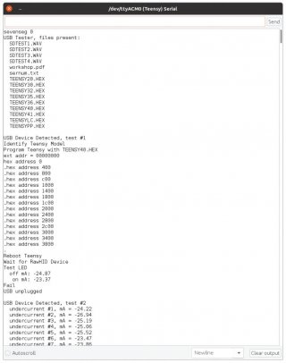

// program blink firmware
bool program_teensy(const char *filename)
Serial.print("Program Teensy with ");
if (!bootloader || bootloader.status() != 1) {
Serial.println(" error, not running bootloader");
return false;
Serial.println(filename);

// use rawhid to test LED, turn on/off and measure current
bool test_led()
Serial.println("Test LED");
if (!rawhid) return false;
usbdata[0] = 0;
memset(usbdata + 1, 0, 63);
rawhid.write(usbdata);
for (int i=0; i < 50; i++) { read_current(); delay(1); }
float led_off_mA = read_current();
Serial.print(" off mA: ");
Serial.println(led_off_mA);
usbdata[0] = 1;
float led_on_mA = read_current();
Serial.print(" on mA: ");
Serial.println(led_on_mA);
float diff = led_on_mA - led_off_mA;
if (diff < 2.0 || diff > 4.0) return false;
return true;
