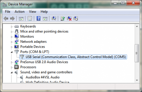

I just went through these steps, on Win7, with the Device Manager open. Since it all works for me, could you go through them as well and say when what you see differs from what I see?
  • Open Device Manager
  • Launch the Teensyduino environment
  • Set board to Teensy 2, USB type to serial
  • Load Examples > Teensy > USB Serial > Hello World
  • Plug in Teensy. Device manager wil probably show an extra HID device (depends on what sketch was loaded before)
  • Compile, upload, press Teensy button
  • Device Manager now shows USB Serial (Communication Class, Abstract Control Model) (COMx)
  • (in my case that is COM5, see attached image)
  • Set Serial Port to that number
  • Open Serial Monitor
  • Hello World is printed
Same thing on Teensy 3.0, which re-used COM5. Apparently multiple USB Serial devices can share a USB Serial COM port number.
