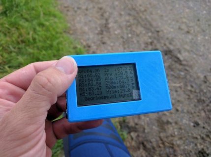

Beginning of last year I started with a Arduino project to see if I could create a simple GPS logger.
Without any knowledge I created a living project
After several revisions I found the Teensy 3.1/3.2 and started to use it with the excellent Ublox GPS.
The idea is to get a similar device build by a manufacturer that can run my code
Atm I'm awaiting official approval from the GPS-speedsurfing.com Tech crew if they allow my device for official postings
The board itself is designed in Eagle and contains
- 800mAh Lipo charger
- Teensy 3.x
- MicroSD for storage and config file
- Big LCD
- Ublox M8q running at 18hz with a helix antenna
- Lipo 1800mAh battery
Software used
- Eagle
- Arduino IDE
- Teensyduino
- FreeRTOS
The project runs at 48Mhz and GPS runs on 18hz
This is my third revision and it works like a charm

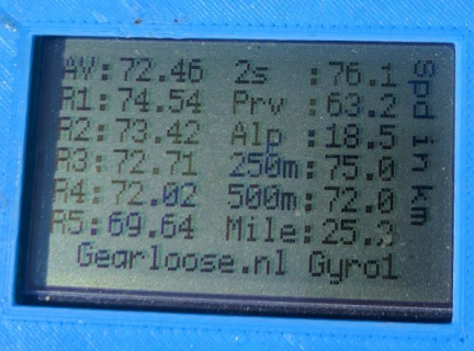

Device Gyro1
3 test boards
Display is in kmh, but can easily display knots

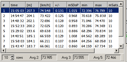

And after all data is verified by software on the desktop.
