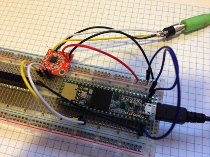

And here is my Teensy setup. Note the output of the DACs are going through a preamp and then on to my speakers. I have also been successful connecting the DAC pins directly to powered speakers. What you can't see in the photo is that I have an external 3.3v power supply hooked up to the power rails running along the top (powering the preamp).
