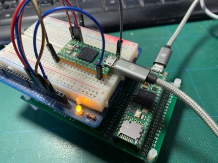

Ok Just completely redid my setup and used my new breakout board:
EDIT: NOTE This is with a T4.1 as master and T4 as slave

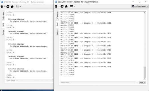

and now its working with the second jumper added:
millis: 605034
BEEF F7 F8 F9 DEAD  --> Length: 5 --> PacketID: 430E
millis: 606035
BEEF F7 F8 F9 DEAD  --> Length: 5 --> PacketID: 5F34
millis: 607036
BEEF F7 F8 F9 DEAD  --> Length: 5 --> PacketID: 5D28
millis: 608037
BEEF F7 F8 F9 DEAD  --> Length: 5 --> PacketID: 6D91
millis: 609038
BEEF F7 F8 F9 DEAD  --> Length: 5 --> PacketID: 7AE8
millis: 610039
BEEF F7 F8 F9 DEAD  --> Length: 5 --> PacketID: 61B9
millis: 611040
BEEF F7 F8 F9 DEAD  --> Length: 5 --> PacketID: 4DAD
millis: 612041
BEEF F7 F8 F9 DEAD  --> Length: 5 --> PacketID: 760F
millis: 613042
Master
643156
State: 0
  Detected slaves:
    Slave 1 --> ID: 0x1234
    Mode: Standalone
As Kurt said - not sure why its needed or >>>
It also works if I take the GND pin between 3.3V and 5V pins on T4 master and connect it next to pin 0 of the slave (not using the GND pin on slave's mid 3.3V/5V area). It also works if I use the master's GND (3.3v/5V pin area) to the USB shield of the slave...
Well - mine is now working if I just connect the GND near pin 0 to the GND on the breakout board I am using - I swapped ground wire and no need for the second ground wire.
EDIT: Just check the PCB design and turns out that my breakout board has the 2 grounds connected :) Got lucky
Lets see if this works
Only works if I go to the advanced menu - not sure what happened
EDIT: The problem as some playing with is with grounds are good with the wires I am using on the this setup because now I how the T4-T4 setup working

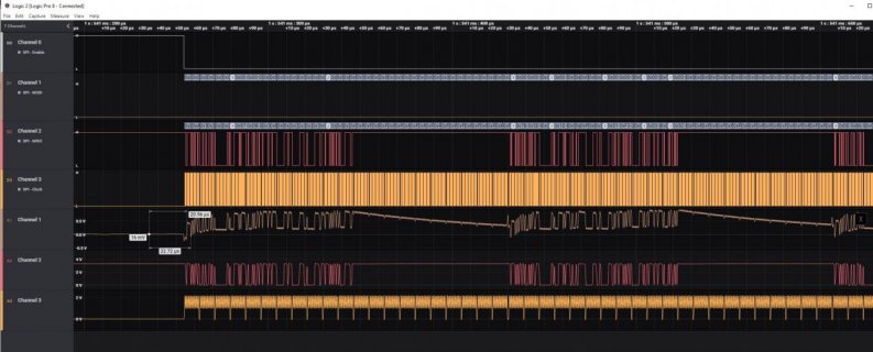

And for another strangeness if I hook up the Logic Analyzer, to the double ground one, it stops working again...
This time I put on both analog and digital capture:
So far I am wondering how the Slave SPIO pins are configured.
