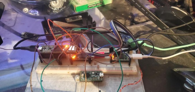

@ALL - earlier today I played with the Master/Slave.
Changed the slave to be closer to what is in the SDK examples:
SPI_MSTransfer_T4_FUNC SPI_MSTransfer_T4_OPT::SPI_MSTransfer_T4() {
  if ( port == &SPI ) {
    _LPSPI4 = this;
    _portnum = 3;
    CCM_CCGR1 |= (3UL << 6);
    nvic_irq = 32 + _portnum;
    _VectorsRam[16 + nvic_irq] = lpspi4_slave_isr;
    /* Alternate pins not broken out on Teensy 4.0/4.1 for LPSPI4 */
    SLAVE_PINS_ADDR;
    spiAddr[0] = 0; /* PCS0_SELECT_INPUT */
    spiAddr[1] = 0; /* SCK_SELECT_INPUT */
    spiAddr[2] = 0; /* SDI_SELECT_INPUT */
    spiAddr[3] = 0; /* SDO_SELECT_INPUT */
    IOMUXC_SW_MUX_CTL_PAD_GPIO_B0_03 = 0x3; /* LPSPI4 SCK (CLK) */
    IOMUXC_SW_MUX_CTL_PAD_GPIO_B0_01 = 0x3; /* LPSPI4 SDI (MISO) */
    IOMUXC_SW_MUX_CTL_PAD_GPIO_B0_02 = 0x3; /* LPSPI4 SDO (MOSI) */
    IOMUXC_SW_MUX_CTL_PAD_GPIO_B0_00 = 0x3; /* LPSPI4 PCS0 (CS) */
    IOMUXC_SW_PAD_CTL_PAD_GPIO_B0_01 = IOMUXC_PAD_DSE(3) | IOMUXC_PAD_SPEED(3) | IOMUXC_PAD_PKE;
    IOMUXC_SW_PAD_CTL_PAD_GPIO_B0_02 = IOMUXC_PAD_DSE(3) | IOMUXC_PAD_SPEED(3) | IOMUXC_PAD_PKE;
    IOMUXC_SW_PAD_CTL_PAD_GPIO_B0_03 = IOMUXC_PAD_DSE(3) | IOMUXC_PAD_SPEED(3) | IOMUXC_PAD_PKE;
    IOMUXC_SW_PAD_CTL_PAD_GPIO_B0_00 = IOMUXC_PAD_DSE(3) | IOMUXC_PAD_SPEED(3) | IOMUXC_PAD_PKE; /* LPSPI4 PCS0 (CS) */
Although speed/dse is different. I added on the PKE. As for the CS, not sure having it default to PD is the best, would think best would be to default to PU...
I made similar changes to SPI for the master one. Again not sure about the CS pin.
But with these changes it appeared to work with just one gnd wire. And that also included having the LA hooked up
At times it is confusing to me, on what the IOMUXC_PAD_DSE(3) means versus IOMUXC_PAD_DSE(7)? It talks about resistor/... but simple question which one produces a stronger more stable signal?
Also wondering about speed. May depend on how long the wires are. I am using some somewhat longer jumpers... Wonder if very short wires will allow higher speeds

Meant to respond to this earlier but been busy today going to appointment. Did try it with my 2 T4 set up and worked as expected without using 2 ground wires. Changing the SPI Clock worked as well. Now for the next question - how do I send data back to the Master. Same as with previous library?
not yet, it's a rewrite so it will need to be added, just wanna check if all good before i continue adding more stuff :)
digitalRead is the only one that actually pulls data from slave at the moment
How you want it since we redoing it? Slave queues up data and master pulls from slave queue i guess? I might have the slave inject queue info in initial requests that pass the correct ID to it before even an ACK occurs, so the master will catch an opportunity to pull queues before event() even runs.
I also make sure it works across daisy chained teensy 4s :)
Welp, I worked on that for you. events() will check whether there are queues or not, and if there are, it will pull it and dequeue from slave only after a valid crc is exchanged.
slave uses same transfer16 function as master, it queues it and master events() will pick it up afterwards. callback is also same for master as the slave, so just copy paste it over, info.slaveID returns the slave's ID of that payload(in case you did like me, have both nodes in same callback, slaveID identifies where it came from). This is working well in daisy chain mode :)
https://youtu.be/NWsuD4hhnHs
Morning Tony
Absolutely fantastic. Can't wait to set something up and try it. Sorry - its hit or miss when I am on-line. Still taking care of a few family things.
@KurtE - @tonton81 - @PaulStoffregen
Was kind of curious of whether the issue with changing the Drive Strength (DSE) and pad speed to 3 was isolated to this case or not. So I broke up @KurtE's SPI Slave test sketch in post #20 in the Teensy 4 as SPI Slave thread into a master and slave sketch using SPI for both master and slave.
And guess what - looks like that DSE/Speed change is necessary since it would not work until I added in the IOMUX settings.

Wow that was fun. Because of the way I defined some defines for centralized access, I was able to make T3.5 to work as a daisy chained slave in this new MST_T4! I am going to do the same method of using offsets since all busses are aligned, just to keep it cleaner than previous versions :)
This is a T4.0 master going to daisy-chained first slave T4.0 and 2nd slave T3.5 :)
Although I havn't tested new additions, it's there for testing.
SPI0 slave support for T3.2
SPI0, SPI1, SPI2 slave support for T3.5/T3.6
SPI0 is currently used and tested on a T3.5, and should work on all T3.x mcus as they use the same register.
That great news and good to hear and sounds like it was fun getting it to work. Still doing stuff with family so may not get to setting up until this weekend. But this is going to good.
Been trying to add LC support but that's not playing nicely so far, especially since we are not playing with 32bit registers (LC=8). That, and the transmit register is 2 bytes versus 1 word. So shared TDR without ifdef's won't be likely with an LC, it's definately more involved than the T3.x's, which took maybe 5-10 minutes to add :)
If I remember correctly you had the same problem SPIMSTransfer (non T4 version). LC was a problem.
