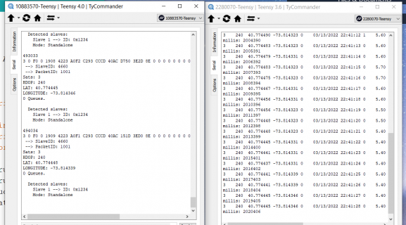

Just added a processing function for master end, instead of having duplicated code in all transfers, they simply pass in a pre-made buffer to it, it does the transfers, and returns a crc pass as well as returned data; Also added analogRead/Write(and Resolution) support as well.
121506
0 Queues.
121507
7 0 82 0 1939 4223 A127 C293 0 4200 0 0 165 0 0 0 0 0 0 0 0 0 0 0 0 0 0 0 0 0 0 0 0 0 0 0 --> Length: 36
--> SlaveID: 4660
--> PacketID: 1001
0 Queues.
121507
0 Queues.
121508

Weird, works fine here, i changed on my slave to use 50 length random arrays and i set both master & 2 slaves to poll write at 10ms rates
