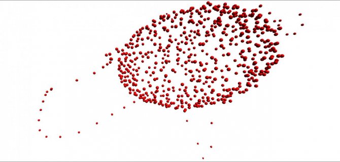

Magnetic Calibration
Hard Iron Offset
37.12
14.83
117.04
Soft Iron Mapping
1.0112 -0.0082 -0.0173
-0.0082 0.9917 0.0323
-0.0173 0.0323 0.9986
