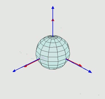

Looks like the visualizers *and* Madgwick filter are using the same external frame Euler angle references.
If you run Madgwick and just watch the data, you can see spinning Teensy + Prop Shield on axis of the USB cable gives roll when the board is oriented one way, but it give pitch when you change the heading/yaw orientation by 90 degrees.
Somehow, I expect an IMU to give roll, pitch and yaw readings like you'd expect from inside an airplane. When the nose of the plane starts pointing downward, that's minus pitch, regardless of whether you're flying from Seattle to LA or NYC. Madgick reports it as pitch if you're flying towards Los Angles, but consides it roll when you're heading towards New York, or some of both if you're flying to Miami.
NXPSensorFusion (Freescale's algorithm) gives roll, pitch & yaw as you'd experience from the aircraft's (intrinsic) perspective.
I managed to change the visualizer to use intrinsic roll, pitch, yaw. Here's the code:

Edit: Screenshot:
It this related to Gimbal Lock like here Gimbal Lock – Rotation order while Animating a Character
> At 2 minutes building to 2:20+ it shows the character having spastic axis rotation - fixed there by changing the order of axis evaluation. This seems to be what WMXZ was alluding to in his post #306
... reports it as pitch if you're flying towards Los Angles, but consides it roll when you're heading towards New York, or some of both if you're flying to Miami.
If a plane from Boston to Seattle diverts to Dallas and suffers a horizon shift . . . which way are the survivors facing?
