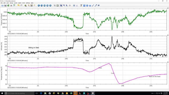

MPL3115A2 Barometer
I tried out the MPL3115A2 barometer on the Prop Shield.
I had success with both the AdaFruit and Sparkfun libraries.
With the Adafruit library, I noticed that there were significant offsets compared to NOAA weather, local altitude and a temperature logger.
I modified the library to output Raw, Tared and Offset data.
Here is a plot of the data with Tare and Offset applied.
Note that at 11 minutes I moved it to the ceiling and then the floor a delta of about 8 ft.
Then at 14 minutes I placed it on top of a warm power supply, then near a muffin fan.
I notice that there are transients in the pressure and altitude as the temperature changes.
I've seen the same phenomenon with the Bosch BMP280 barometer sensor.
Here's the plot:

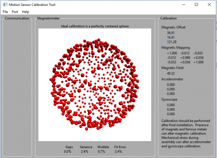

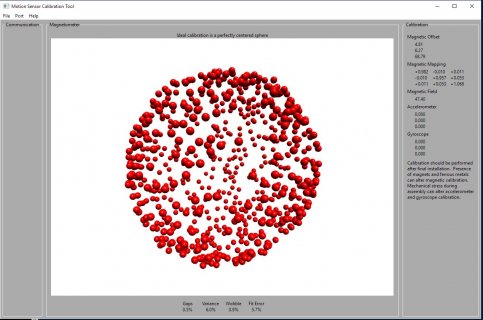

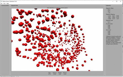

Here is a new build of a calibration app. NXPMotionSense recently changed to a new calibration data set & protocol. This is the first calibration app to write the new format.... so make sure you're running the latest on your Teensy.
This version adds much more info to the GUI.
I've tried to fix the problem(s) that were crashing on Mac. Both Windows and Mac still crash when you quit, but the question is whether they're stable while still running?
http://www.pjrc.com/teensy/beta/imuread/gui.linux64
