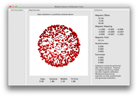

I also noticed that on my WIN10 PC the Motion Sensor Calibration Tool does not read the port unless another program has read it first.
It's OK if I remove the line: while (!Serial) ; // wait for serial port open
Crashed on exit
RE Mac, if nobody has this in their sight to compile the Teensytransfer for Mac, I will have a look at it over the weekend.Yes, that's an issue in the old MAC Version. It is solved for Windows and Linux.
Unfortuantely, i can't compile it for MAC.
