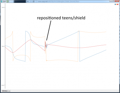

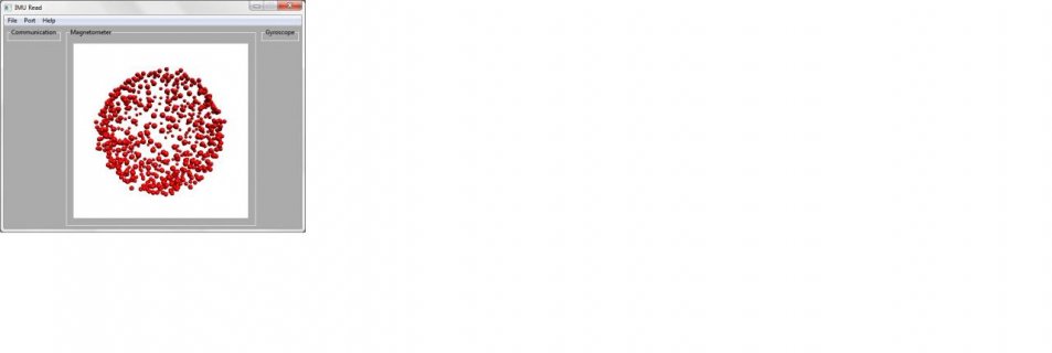

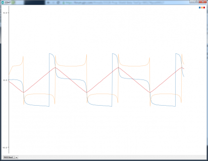

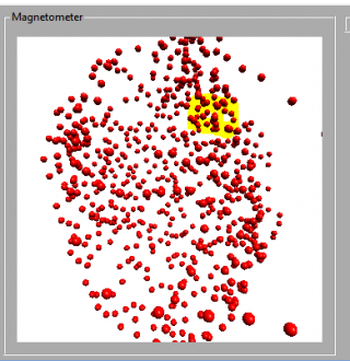

Also, please let me know if are you able to resize the window? If you can, does the graphic part grow as you change the window size?
On Windows I cannot resize the window. Maximize and titlebar icon is grey, and no resize borders. Image below with a yellow highlight where I see the active jitter as it sits after waving it around.
I powered down and pulled off the ESP board and the speaker - then wiggled it around on the USB cable and got the second rounder image.
<edit>: interesting VOID area persists after sitting and moving - it is visible in the _Cal2 image.

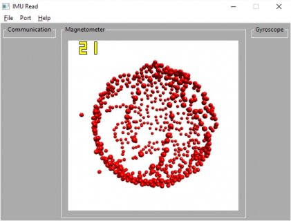

I ran FRAPS on the GUI window and it reported a consistent 21 frames/second.
On my system I am unable to resize or maximize the window.I am unable to catch the corner to drag to resize, and the maximize Icon in the upper left corner is greyed out.
Here's screencap with FRAPS running:

On my Fedora 22 system, I can resize the window, and the graphic inside DOES resize. I am using the mate window manager.

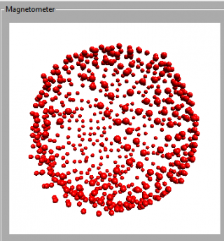

mag calibration
I was able to mostly fill in the calibration sphere by much trial and error, slowly pointing the board in different directions. I clicked on the item to load the calibration but I don't know if it did anything.

New version is nicely Windows resizable. Good uniform sphere. Did Send Calibration.

I got a nice sphere, despite of my compact build with an additional "connector"board between the prop-shield chips and the Teensy,

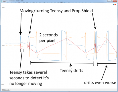

It might be a problem with my hardware, sometimes when I move the Shield, like when filling the cal gui with data points, the orientation begins to drift on all axes in a weird but repeatable pattern. I'm using the "Orientation" example modified to 2000ms update intervals right now to record this behaviour on the arduino serial plotter. I'll edit a screenshot here in a couple minutes.
Edit:
Of course, but I don't actually know how :rolleyes: I'm more of a hardware guy... so any help/hint appreciated!
Use the MagdwickIMU example that comes with the library. Maybe grab the latest copy of the library, which has a little more documentation in the comments.

Looks to me like Ben's system is not accurately calibrated, or not calibrated at all. It would be easier to debug if (1) there was some confirmation that the calibration data was written to memory and (2) some quality metrics on the calibration data (self-consistency) and maybe (3) some real-time monitoring for self-consistency, eg. does the currently measured field vector have the same magnitude as the original calibration did, and does the magnitude change with time? If it's too big that implies a local magnetic source. If it's too small, it means presence of an opposing field, or that you've moved into a magnetically shielded chamber, or well away from the planet's surface...

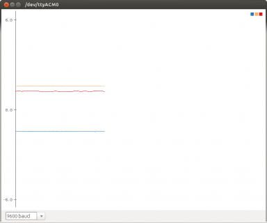

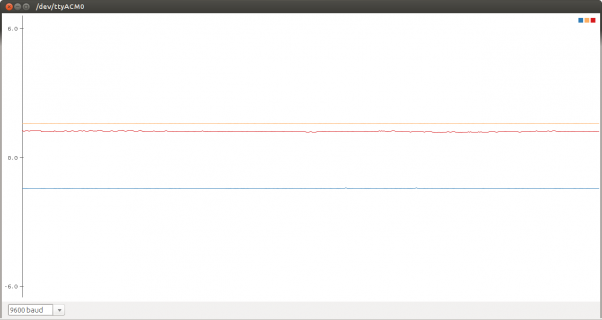

I've been running it here for 2 hours. I changed the code to print once every 10 seconds. Here's what I'm seeing with the Orientation example.
Edit: this was with the Teensy and Prop Shield hanging on the end of a short USB cable, dangling off a USB hub that's mounted to the side of my workbench.
