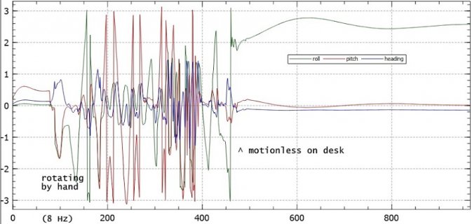

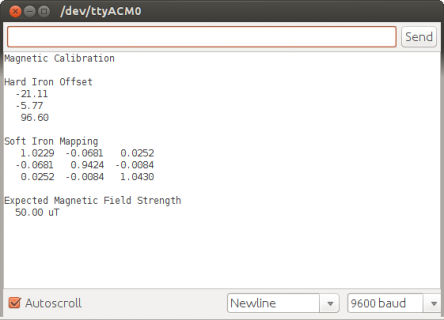

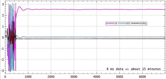

Looks to me like Ben's system is not accurately calibrated, or not calibrated at all.
It would be easier to debug if (1) there was some confirmation that the calibration data was written to memory and (2) some quality metrics on the calibration data (self-consistency)
and maybe (3) some real-time monitoring for self-consistency, eg. does the currently measured field vector have the same magnitude as the original calibration did, and does the magnitude change with time? If it's too big that implies a local magnetic source. If it's too small, it means presence of an opposing field, or that you've moved into a magnetically shielded chamber, or well away from the planet's surface...
Paul, In your Madgwick implementation it looks like you are not using the mag data at all. Do I understand this correctly? In this case the gyro drift will be all too apparent very quickly...
// Update the Madgwick filter
//filter.updateIMU(gx, gy, gz, ax, ay, az);
//filter.update(gx, gy, gz, ax, ay, az, mx, my, mz);
filter.update(-gx, gy, gz, ax, -ay, -az, mx, -my, -mz);

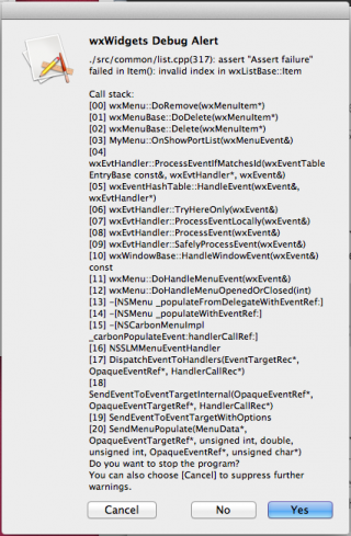

Process: gui [77248]
Path: /Users/USER/Downloads/gui.app/Contents/MacOS/gui
Identifier: com.pjrc.teensy
Version: ??? (???)
Code Type: X86-64 (Native)
Parent Process: launchd [255]
Responsible: gui [77248]
User ID: 501
Date/Time: 2016-03-16 18:17:48.551 -0700
OS Version: Mac OS X 10.9.5 (13F1603)
Report Version: 11
Anonymous UUID: F4335842-4EF9-0B79-3DB7-D9A0441E0985
Crashed Thread: 0 Dispatch queue: com.apple.main-thread
Exception Type: EXC_BAD_ACCESS (SIGSEGV)
Exception Codes: KERN_INVALID_ADDRESS at 0x0000000000000010
VM Regions Near 0x10:
__TEXT 0000000100000000-000000010049a000 [ 4712K] r-x/rwx SM=COW /Users/USER/Downloads/gui.app/Contents/MacOS/gui
Thread 0 Crashed:: Dispatch queue: com.apple.main-thread
0 com.pjrc.teensy 0x000000010007669c wxMenu::DoRemove(wxMenuItem*) + 156
1 com.pjrc.teensy 0x000000010018471d wxMenuBase::DoDelete(wxMenuItem*) + 13
2 com.pjrc.teensy 0x00000001001847b2 wxMenuBase::Delete(wxMenuItem*) + 18
3 com.pjrc.teensy 0x0000000100032502 MyMenu::OnShowPortList(wxMenuEvent&) + 210

Hard Iron Offset
-0.51
15.25
70.61
Soft Iron Mapping
0.9821 -0.0104 -0.0133
-0.0104 0.9797 0.0035
-0.0133 0.0035 1.0396
Hard Iron Offset
-0.70
16.40
71.02
Soft Iron Mapping
0.9770 -0.0141 -0.0154
-0.0141 0.9824 0.0042
-0.0154 0.0042 1.0424
2.529,0.044,-0.123
2.529,0.044,-0.123
2.528,0.044,-0.123
2.528,0.044,-0.123
2.528,0.044,-0.123
2.528,0.044,-0.124
2.527,0.043,-0.124
2.527,0.043,-0.124
2.527,0.043,-0.124
2.526,0.043,-0.124
2.526,0.043,-0.124
2.526,0.043,-0.124
2.526,0.043,-0.124
2.526,0.043,-0.124
2.527,0.043,-0.124
2.527,0.043,-0.124
2.527,0.043,-0.124
2.527,0.043,-0.124
2.528,0.043,-0.124
2.528,0.043,-0.124
2.528,0.043,-0.124
2.528,0.043,-0.124
2.527,0.043,-0.124
2.528,0.043,-0.124
2.527,0.043,-0.124
2.528,0.043,-0.124
2.527,0.043,-0.124
2.528,0.043,-0.124
2.528,0.043,-0.124
2.528,0.043,-0.124
2.527,0.043,-0.124
2.527,0.043,-0.124
2.527,0.043,-0.125
2.527,0.043,-0.124
2.527,0.043,-0.124
2.527,0.043,-0.124
2.527,0.043,-0.124
2.527,0.043,-0.125
2.526,0.043,-0.125
2.526,0.042,-0.124
2.527,0.043,-0.125
2.527,0.043,-0.125
2.527,0.042,-0.125
I was under the impression that Dotstar and APA102 were the same.
