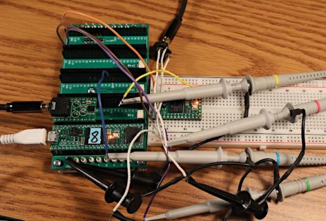

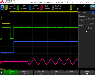

I ran the code here and measured the response time with my oscilloscope. I'm seeing approx 3 to 5 ms from the end of the MIDI message until the PT8211 starts the sine wave output.
To test, I used a Teensy 4.0 running this code to send the MIDI messages.
#include <MIDI.h>
MIDI_CREATE_DEFAULT_INSTANCE();
  pinMode(13, OUTPUT);
  MIDI.begin(0);
  digitalWrite(13, HIGH);
  MIDI.sendNoteOn(64, 64, 1);
  digitalWrite(13, LOW);
  MIDI.sendNoteOff(64, 64, 1);
  delay(1500);
I ran the code from msg #1 on a Teensy 4.1. Only edit was to uncomment the #define PT8211 line.
Here is the hardware on my workbench, so you can see how I tested.
I connected the oscilloscope to pin 13 on both boards, and to the serial data line, and of course the PT8211 output.
This scope setting is 2 ms/division. You can see the blue trace (LED on Teensy 4.1) goes high very quickly after the end of the MIDI message (green trace), and then just under 2 divisions later the PT8211 starts creating the sine wave.
