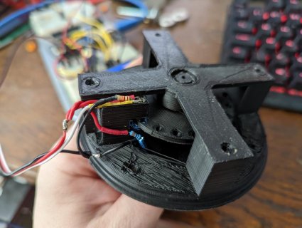

I have been asked to build a weather station for a friends kids, it's going to be a teaching aid for them.
I built the main bulk of the anenometer. It makes use of a holed disc, reverse polarity photodiode with an LED as a light source.
The speed output is only based upon the distance between the holes on the disc. I have not been able to calibrated in anyway as yet.

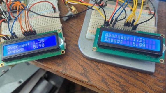

During some thinking and testing using an arduino uno, I thought that using a teensy 4.0 that I had here. This led to setting them up side by side with the signal going to both from a single sensor.
With the disc being spun by a drill so that the speed is consistant-ish, I get a 1-2 tenths variation on speed, but the bigger concern is there is a noticble difference between the uno and the teensy 4.0 readings
Is this likely due to the teensy having a faster clock, or a more accurate floating point facility to do the sums with, or is there something else that I have over looked?
Which one do you folks think is more accurate?
The same code is used on both.

Possibly the difference is due to the difference in VIH, VIL of the Arduino vs the Teensy, one being a 5 volt input and the other 3.3 volt . They will detect high and low at different levels of signal. A slow slew rate of the signal out of your photo diode would make the difference more pronounced.
I did hook my cheap USB scope up to the the diode, seemed fast enough. But for some reason I did not think threshhold.
Thinking about it, i could have the teesny produce a PWM signal and have them both read that back and see what the discrepency is.
Thanks.
Sorry for the double post, but i have tested with using a pwm signal.
Both seem to produce about the same results, although the uno is a lot less stable. The uno shows a result flickering between .30 and and .40, while the teensy 4 flickers in such a way that it cant really be read but i think it might be between .46 and .67 with a the teensy producing a PWM - analogWrite(1, 128);
Using a potentiometer to adjust the PWM on the fly shows that they produce the near enough the same results.
My conclusion is that, rcarr, you were right on the money.
However the fact that the teensy produced the more stable result would lend to my thinking that the teensy was producing more accurate result and more consistanly.
