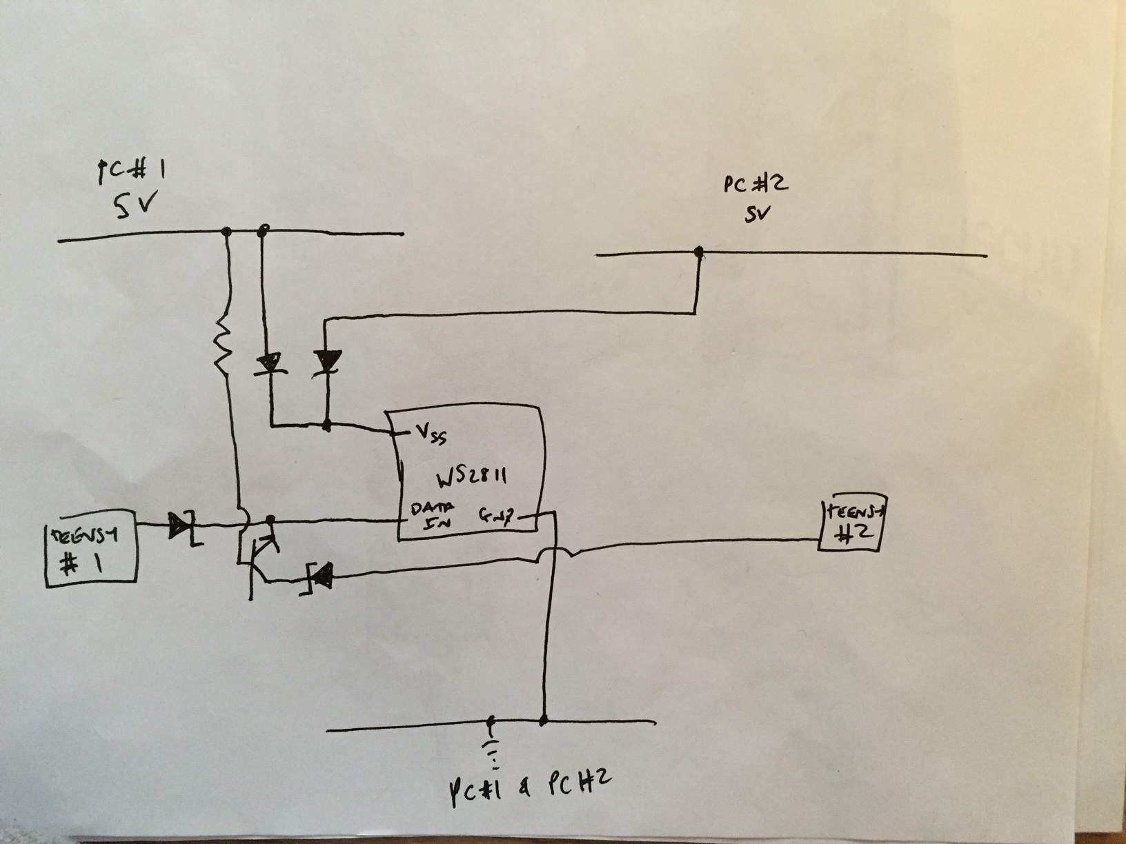

This is my initial thought. It isn't completely failsafe in terms of the LEDs remaining on, however as far as I can see it would never allow the WS2811 to be powered and/or received data from two sources.
I've actually drawn the diagram slightly wrong. The idea is to have a depletion mode MOSFET controlled by the USB power of Teensy #1. That way, the data line from Teensy #2 only ever gets connected if we're sure that there is no power coming from the first Teensy. Also I don't think there is any need for either Schottky diode.
Worth being aware that the WS2811 waveform is pretty sensitive to slew rate (how square the waveform is). So those diodes will probably be a problem since the circuit needs to activly sink current to pull the level down. Did at one stage make a discrete transistor level converter and found the hard way that it's very easy to destroy the pulse train enough that the self clocking breaks down, so you need a way for Teensy #2 to pull the line level down, which won't work through that transistor. Would suggest either some prototyping or some time with a simulation package looking at how much any solution mucks with the square edges of the waveform.
Also the design as drawn has no level conversion, assuming these are T3.X 3.3v devices?
One two birds with one stone option would be to use a schmitt triggered logic gate (OR I think would be easiest to work with) and use that to combine things, assuming you can code Teensy #2 to not send data while Teensy #1 is functioning.

Include some way of the backup teensy (T2) monitoring the output of the main teensy (T1) in order to know when to switch over control; you can either directly probe the data from T1 or send a "still alive" signal from T1 to T2. As long as T2 sees this signal it will do nothing, when it stops T2 will take over. Then you can just combine the data lines together. Gremlinwrangler suggests using an OR gate, which I would simplify to another pair of diodes.
It seems nasty but it has the same effect as an or gate, but should preserve the waveform a little better. The 37 ohm resistor there is recommeded on the datasheet for the WS2811 i found at adafruit.
Of course the bigger question is what kind of failure you're anticipating/protecting against. This soloution will only work if T1 fails and stops driving it's data out - should it hang with the ouput high T2 will be unable to change the output. If you're protecting aggainst power loss to T1 then this will be fine, as the Diode will prevent any power flowing back into the pin.
In terms of a perfect switch-over from T1 to T2 without any loss that's probably impossible without an-over engineered solution. You'd have to perfectly syncronise both chips and have T2 take over as soon as T1 stops, and even then you'd have at least one bit in error, unless failure occured during the reset time. That being said you should be able to switch over control faster than the eye can notice!
