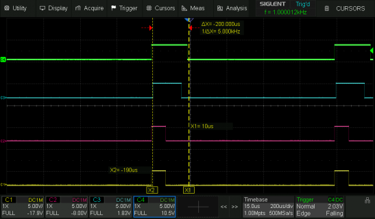

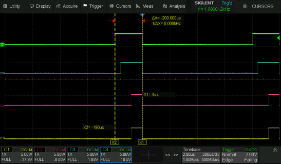

I'm working on a document describing a satellite ELINT system from the 1970's (That's old enough that I can actually find declassified technical information.) I want to simulate the display the ground station operators would see if they were receiving two channels of data from each of two satellites. The timing of the intercepted radar pulses could be used with Differential Time Of Arrival (DTOA) techniques to locate the emitting radars. When I set up T4.1 with 4 PWM outputs from pins 14, 15, 18 and 19, I got some puzzling results. (Those pins use channels 0,1,2, and 3 of quad timer TMR3.) Since I set up and started all the PWM outputs in quick sequence, I expected all the outputs to rise within a few microseconds of each other. No Such Luck! All the falling edges were lined up! I found that inserting some delays between initializations would result in a fairly close line up of the leading edges. However, the values and positions of the delays don't seem to relate to the shift in the pulse positions. A key factor seems to be that two PWM outputs with the same pulse width line up nicely. DOH! if the pulses are the same width and the trailing edges line up so will the leading edges! I need to use different pulse widths because the ELINT system combined up to four receiver channels on a single downlink by using different pulse width for each channel. (80,120,160 and 200 microseconds high time with a nominal 1000microsecond Pulse Repitition Interval (PRI).
The simplified demo code is attached as are two scope screenshots. Does anybody know what's going on with the PWM initialization?
Does this mean you want two independent pairs of PWM signals, and be able to control the phase difference between the two signals in each pair? Or is there some relationship between all four? The eFlexPWM library has some good examples of controlling phase between signals in sets of two and three, though center-aligned by default.
https://github.com/epsilonrt/eFlexPwm
Yes, I want to have two pairs of two traces representing two different satellites receiving pulses from two different radars. One pair, representing the signals from one target will have 80uSec pulse widths. The other two traces will represent the same pair of satellites receiving pulses from a different radar and will be displayed with 160uSec pulses. Since the pulses from each radar will have unique PRIS, the trace from one satellite will not drift with relation to the other, but will be offset by the difference in path lengths from the radar to the satellites. The traces representing the second radar also won't drift with respect to the data from the other satellite but may drift A LOT with respect to the signals from the other radar if its PRI is significantly different from the first radar. Explaining all this is why I want pictures or a movie to show the traces.

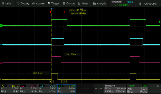

Getting the output I wanted required these steps:
1. Turning off the output inversion bit in the status and control register.
2. Munging the PRI and High Pulse Width into a new value for analogWrite--basically swapping the COMP1 and COMP2 values.
3. Scaling the duty cycle from fixed uSecond values to the 1024-unit maximum
The results are shown in the attached screen shot. The new code follows:

Updated demo code to display two pairs of traces. One of each pair has a constant phase offset from the other. The one pair has a PRI 100nSec longer than the other, which causes the top pair of traces to scroll with relation to the bottom two.

This short movie shows the results of the Teensy PWM signal output. The movie is a bit jerky as it is a screen capture screen made with the Windows snipping tool. Apparently, my 5-year-old PC has trouble keeping up with network transmission from the scope, through my router to the PC, displaying the MP4 data on the screen, capturing the screen image and storing it in a file. There's probably a better way, but dinner awaits.
Doesn't surprise me at all. Pretty standard for a PWM peripheral in fast mode, initial state low, goes high when the compare register matches, resets on the end of cycle. Its been a while since looking at the T4 PWM hardware but I'm pretty sure it can be configured to invert the output sense.
Hi, I work against a Teensy 4.1 within some other areas and I almost get all my Code written by either Claude Opus 4.6 or GPT 5.3 Codex these days (I also think Grok will be in that level or better within the next 2 months). Anyway, I'm on travel and dont have my developer tools here but I asked GPT 5.2 about this and got the answer below, I hope it might help you but also take it with some salt because they still have a little dose of Hallucinations :) Also, if you want me to use AI to look into it further you can send the last scope part 5.2 asked for and I can feed it back to "him" :)
this is absolutely in-scope, and what you’re seeing is very consistent with how the Teensy 4.x core sets up PWM on the i.MX RT1062 QuadTimer pins (your set: 14/15/18/19 on TMR3).
Why all the falling edges line up​
On Teensy 4.x, analogWrite() on QuadTimer-backed pins is implemented in a way that effectively makes PWM edge-aligned to a common reference inside each timer channel. In the default configuration used by the core, the “fixed” edge is tied to the timer’s reload/overflow boundary, and the duty setting moves the other edge via a compare value.
So if the core config is “clear output at reload and set/clear at compare” (or the inverted equivalent), then:
  • the edge tied to reload occurs at the same point each period, so it looks phase-locked
  • changing duty cycle moves the other edge earlier/later in the period
  • if you choose duty values that correspond to identical pulse widths, then of course those moved edges coincide too (your “DOH” observation)
This is also why inserting delays between init calls gives “mysterious” phase shifts: you’re not just delaying your code, you’re changing which cycle boundary each channel first latches its new compare values onto.
The bigger gotchas in your specific code​
1) You are not actually resetting phase when you “stop”​
TMR3_ENBL = 0; stops counting, but it does not guarantee the counters reload to a known phase. If the counter resumes from wherever it stopped, your “start times” are inherently inconsistent unless you also force the counter/reload state.
That alone can make “quick-sequence init” not produce aligned rising edges.
2) ^ 0x0002 is a phase-randomizer over repeated calls​
You’re toggling the inversion bit with XOR:
TMR3_SCTRLn = TMR3_SCTRLn ^ 0x0002;
Every time InitPWM() runs, that flips polarity again. If you call it repeatedly (your original loop does), the waveform meaning (which edge is rising/falling) flips every time. That can easily make your scope captures look “puzzling” even when the underlying timer behavior is consistent.
Instead, set or clear the bit explicitly, e.g.:
TMR3_SCTRLn &= ~0x0002; // clear inversion
// or
TMR3_SCTRLn |= 0x0002; // set inversion
3) Your later SetAnWrite() computes low-time, not high-time​
You compute:
pwdth = ANSTEPS*(pri - pwhi)/pri;
analogWrite(pin, pwdth);
That is “duty = (period − high_time)”, i.e. you’re deliberately programming the complement. Combined with output inversion games, it’s very easy to end up in a mode where the trailing edge is naturally locked.
4) PRI2 = 1000.1 µs is likely being quantized away​
analogWriteFrequency() ultimately has to pick integer divider/count values. A 0.1 µs change at ~1000 µs PRI is 100 ppm; depending on the selected clock and prescaler, that might be below the timer’s achievable resolution for that configuration, so your “100 ns longer PRI” may not actually be realized (or it may dither between adjacent integer settings). (General PWM grouping/limitations are also documented by PJRC: pins in the same PWM timer group share constraints.)
What’s “going on” with initialization​
Two key implementation details typically bite people:
  1. analogWriteFrequency(pin, …) may configure and enable the underlying timer channel immediately (or leave it running while you configure other pins). So channel A starts counting before B/C/D are fully configured.
  2. Compare values often latch on reload, not immediately. So depending on when you write duty vs where the counter is, the first “real” pulse can come out phase-shifted by up to almost a full period.
That produces exactly the pattern you described: a stable-looking alignment of one edge, and “random” seeming offsets of the other, sensitive to tiny code-timing changes.
How to make all four channels start in-phase (reliably)​
Option A (best with QuadTimer): reset counters + enable all at once​
Do this sequence:
  1. Disable all four
  2. Force each counter to a known value (typically LOAD or 0)
  3. Program frequency/period and compare values for all four
  4. Enable all four with a single write to TMR3_ENBL
Conceptually:
TMR3_ENBL = 0; // stop all
TMR3_CNTR0 = 0; TMR3_CNTR1 = 0; TMR3_CNTR2 = 0; TMR3_CNTR3 = 0; // force phase
// configure LOAD/COMP/CTRL/SCTRL for all channels here
TMR3_ENBL = 0b1111; // start all simultaneously
Important: don’t XOR inversion, and don’t OR-enable one bit at a time if you care about alignment.
This aligns the reference edge (reload edge) across all four channels as tightly as the bus write timing allows (effectively “same cycle”).
Also: NXP’s own discussions of QuadTimer synchronization explicitly describe starting multiple channels together by setting multiple enable bits simultaneously.
Option B: change which edge is fixed (if you want rising edges aligned)​
If you want rising edges aligned and variable pulse width by moving the falling edge, configure the output action so that:
  • output is set at reload
  • output is cleared at compare (compare represents high-time)
Right now you appear to be in the opposite (or inverted) relationship, so the falling edges are the natural lock point.
With raw QuadTimer register control, you can choose the output mode to make the rising edge the fixed edge.
Option C: use FlexPWM pins if phase control is a first-class requirement​
If you can move pins, FlexPWM has more explicit phase/sync machinery than QuadTimer. PJRC explicitly notes “PWM groups” sharing hardware constraints; picking pins from appropriate groups matters.
Quick fixes you can apply immediately to your test​
  1. Replace every ^ 0x0002 with explicit set/clear.
  2. After TMR3_ENBL = 0;, also write all TMR3_CNTRn = 0;.
  3. Enable all channels in one shot: TMR3_ENBL = 0b1111; (not OR’ing one at a time).
  4. Don’t expect 1000.1 µs to be represented faithfully unless you verify the actual programmed divider/count.
If you do just (1)–(3), you should see deterministic, repeatable phase behavior — and you’ll be able to choose whether rising or falling edges align by selecting the output mode/polarity once, instead of letting it drift per init call.
If you paste the two scope screenshots (or describe what the top/bottom traces correspond to in the revised code), I can tell you which edge is tied to reload in your current setup and which specific QuadTimer output mode bits you need to flip to make the leading edge the fixed edge (so your widths encode channels exactly like the 80/120/160/200 µs POPPY-style multiplexing).
// or
You compute:
Do this sequence:
  1. Disable all four
Conceptually:
