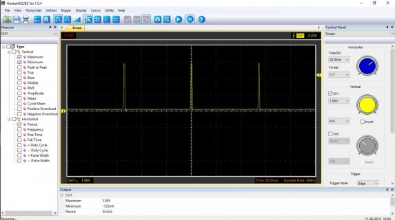

I'm generating a PWM clock that varies between 1mhz to 191khz according to a midi cc controller. Ive been reading up on duty-cycles in variable pwm situations and have tried to design this in respect to the f_bus (60mhz t3.6), my understanding is that even divisions of f_bus allow pwm to stay at 50% duty?
What I've done is filled a 127 slot array with even divisions of 60,000,000 (60, 62, 64, 66, etc)
I've verified reading out the array after to serial that it is filling to with the right values, i.e;
16:49:38.783 -> 1000000.0000000000
16:49:38.783 -> 967741.9354838709
16:49:38.783 -> 937500.0000000000
16:49:38.783 -> 909090.9090909090
16:49:38.783 -> 882352.9411764706
16:49:38.783 -> 857142.8571428571
16:49:38.783 -> 833333.3333333333

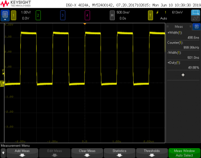

The issue is that I am not measuring 50% duty cycle near the high end of the clock, the duty reads duty+ 46.9%, duty - 53.1%. As i slow down the pwm clock the duty gets closer to 50/50, but not at the high end. Also, is this normal for a pwm out signal @ 1mhz, was hoping for something more clean. See;
https://ibb.co/8bsZCsj
Everything is going well for the most part, but i am getting some glitches in the instrument I'm controlling, sometimes it crashes. Trying to rule out duty issues.
the code i'm using to write on midi cc changes is simply;
Any ideas about the irregular duty cycle at 1mhz end of the scale?
Thanks in advance
