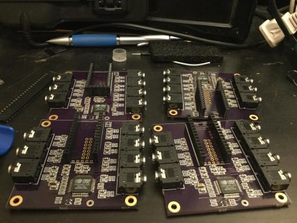

Here are pictures of a few of the 7 that I have made. :confused:

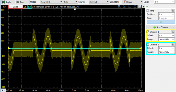

I seem to be getting the same thing you are: (this should be a sine wave at 440)
My guess is that this is a problem with the clock settings or the buffer, not with the hardware. It looks to me like maybe half the buffer is empty or the LRCLK is 2 times too long. Paul, do you have any ideas?
Synthcat,
I figured it out....your missing code and your o-scope output above made me think that this memory value needs to be higher....I used 300 and it sounds like heaven. Thank you for helping me working through this! I'm doing the multi-channel dance! :eek:
Yes, the TDM input needs 16 memory just to have buffers to store the incoming data, then you need more on top of that just to do anything.

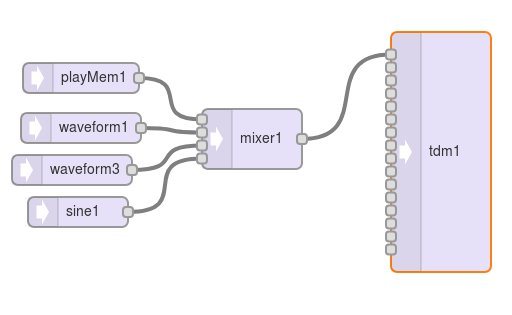

I'm having an hard time to understand how to patch the CS42448 ins and outs and how to use the TDM.
I can't understand were i should plug my end of chain signal on the TDM object, do i need an extra I2S object?
Let's say i want to output a mixer signal on output channel 1...
is there a simple example code for this?
