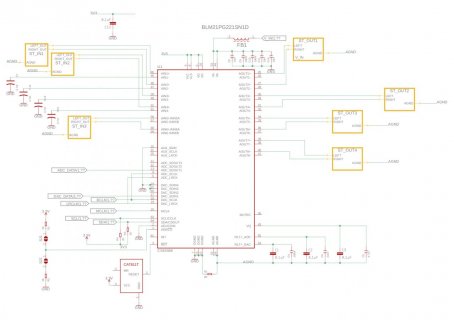

Quad channel output on Teensy 3.6

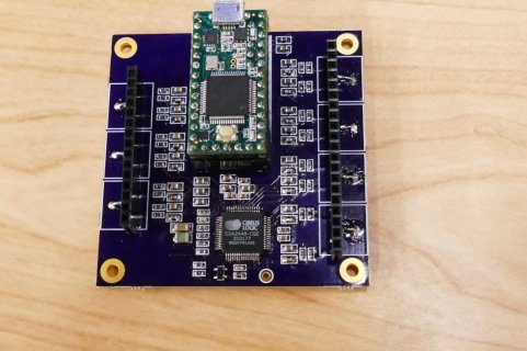

Thats great feedback! Thank you Paul - really appreciate that... I will make amendments...
Thanks again. I've made the corrections you've suggested, although I was slightly unsure of these things:
if the decoupling caps for VA should be before or after the ferrite bead.
if the CAT811T is wired correctly.
if PIN1 / CS is setup correctly with two resistors and solderable pad options. Due to my inexperience, I wasn't sure how to represent this on a schematic.
pdf: View attachment 16306

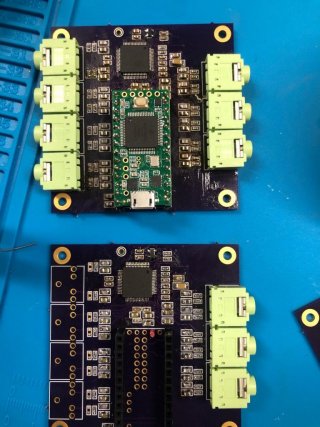

If you make one of these boards, please join the conversation!
I bought three of these boards back when they came available. After sleeping on the shelf for nearly a couple of years, I grabbed one and set out to do my first SMD build in about 5 years. I can solder up a vacuum tube amp board in about 3 hours, but I designed it so I know where all the parts go. This little guy took me three days of squinting through a microscope and soldering my fingers. It's kinda ugly, and not all of the parts are the right size, but it's finished.
I popped a T3.2 on top and loaded up the code I made from the fragment on the OSH park page and the original "guitar' code. I wired the mixed to all 8 output channels so I could test them. After fixing a few typos it worked. This will be part of the fourth music synthesizer I have built with a Teensy as the "brain." I tested with a T3.2, so that there were minimal variables in case things didn't work. The T3.6 will be next. This one will be a 6 voice polyphonic hybrid digital /analog synth with Moog style ladder filters for that fat Moog sound. P2580711_x.jpgP2580612_x.jpgP2580631_x.jpg

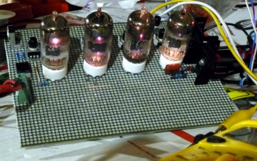

Here is a picture of a Moog style ladder filter breadboard made with vacuum tubes.....it won't fit in the guitar, so i'll keep working on the SMD stuff.
hi there,
I had the same issue as mmalex with the CS42448 not working properly, VQ at 1.25V instead of 2.5V and muted outputs.
my fix for it is to set bit 0 (a reserved bit) in the CS42448 FunctionalMode register to 1:
        // set the magic bit!
        __write(CS42448_Functional_Mode, 0xF4 | 0x01 );
I contacted Cirrus support and they told me it's not possible and the chip should work without that bit set - well as mmalex and me found out that is not true for all chips or setups.
we have this on 3 prototype boards so its also not an one-off soldering error.

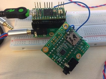

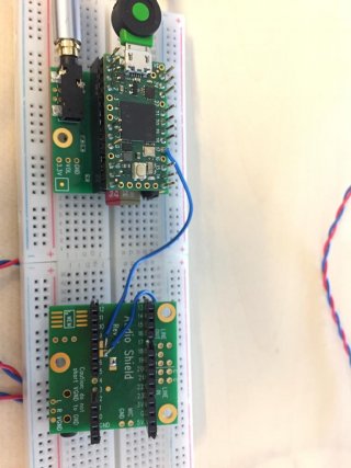

Hi all,
I'm new to this forum so I hope that this question still fits inside this thread. Also new to Teensy, coding and soldering altogether so let me know if I need to up my clear question asking skills.
For my graduation research I want to use the Teensy 4.0 together with two audio shields to send waveforms to 4 seperate VCA's. With this Sparkfun guide I reworked one shield where I:
  • Removed the Caps on both shields
  • Cut traces between pin 8 & pin 7 instead of pin 13 & pin 22 on Teensy 3.2
  • Cut between the center & right pad of I2S pads
  • Wired innerpad of pin 7 to pin 15 instead of innerpad pin 22 to pin 15 on Teensy 3.2
  • Wired innerpad of 8 to pin 17 on the Teensy instead of pin 13 to pad 30 on Teensy 3.2
  • Put a solder blob in between center and left I2S pad
Using the QuadChannelOutput.ino example does not seem to work though. playSdWav1.isPlaying() remains false.
Both Shields worked separately(before rework) using WavFilePLayer.ino.
Jumper wiring pin 7 to 15 and pin 8 to 17 makes the second shield work as well.
I also multimetered the I2S connections, they should be fully separated.
So I do not expect it to be a problem in wiring.

Sorry, your pictures are exactly as you tested them, i.e. there is ONLY 1 wire between 2nd audio shield and Teensy?
Obviously ALL wires that from Teensy go to Audioboard 1 should also go to Audioboard 2, only the I2S_RX and I2S_TX of audio cards com from different places on Teensy, and maybe CS if you using uSD card.
It is not visible on Picture, I assume you have Audioboard rev D for Teensy4.0
Hi WMXZ, thanks for your reply! You are right, they are stacked when I use them. The SD card is read from both sloths so that connection works.
And indeed they are rev D's!
without checking sparkfun instructions (and without having it done myself) I would assume
on audio board1,
connect straight:
MCLK A.23 to T4.23
BCLK A.21 to T4.21
LRCK A.20 to T4.20
SDA A.18 to T4.18
SCL A.19 to T4.19
DIN A.7 to T4.7
DOUT A.8 to T4.8
on 2nd audiocard
connect A.7 (DIN) to T4.32 (OUT1B ) (found on bottom)
connect A.8 (DOUT) to T4.6 (OUT1D)
if you do not stack pins 7,8 to 2nd audioboard but use wires, you may not need to cut connections 7,8 on 2nd audioboard.
For I2C address cut Pads on 2nd audioboard (triple pad) and connect where not previously connected.
SW to be used is I2S quad, but I'm not sure if that was ported to T4 and tested. But connection method is for SAI1 using 2 adjacent data ports.
Hi WMXZ,
Thanks, the connection on the 1st board are as you said. Though I wonder what your train of thought was on connecting pin A.7 & A.8?
on 2nd audiocard
For the T3.2 connections on the 2nd audio shield would be:
connect A.22 (DIN) to A15
connect A.13 (DOUT) to T3.2 pad 30 (SDA1)
So my translation to the T4 was:
connect A.7 (DIN) to A15
connect A.8 (DOUT) to T4 pin 17 (SDA1)
Does it require the digital Audio capabilities?

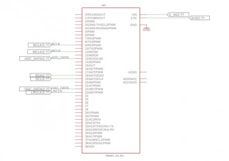

Sorry for the necrobump. Having some trouble getting the cirrus chip to respond. The return value from the enable function is always false. I assume maybe its my soldering. Ive tried twice, once via an iron and after a trip to a store, via hot air for the second board. First board is likely bridged on a pin but the second board looks clean. I ran the hot air at 260C but struggled to find guidance in the data sheet for a temp to reflow at. Before i bork the last chip I got. Does any one have some troubleshooting tips?
I checked a few of the pads and made sure the power was running thru the ferrite bead. The chip was not getting hot, so i checked it with a Flir. Slightly above ambient, but not running warm/hot as mentioned. Maybe for the last board I only add the min parts for comms with the chip and see if it communicates?
Code: https://pastebin.com/hZiBbgjY
Designer: Screen Shot 2020-11-11 at 6.30.51 PM.jpg
What I do in those cases is to get thin contact probes, and check for continuity along all the paths that should have it (and not among some that shouldn't.)
Then I use those probes, and IDEALLY some test points on the board (if I remembered to put them in) to hook up a scope to make sure that the wires wiggle.
If that works, I break out the logic analyzer and start debugging the protocol.
