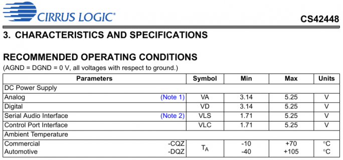

Hi Paul and everyone. I'm designing a similar board to use Teensy with the CS42448 and was wondering if it'd be possible to use 3.3V for VA? I need to make it battery-powered (lithium 3.7-4.2V) so I was planning to just have a battery connected to VIN and use the regulated 3.3V to power all the rest. On the datasheet it says the CS42448 can operate from 3.3 to 5..so it should be possible, right?
In this case, could I just connect VA and VD with a ferrite bead to separate the 3.3V lines? Any suggestions? Thanks.
The datasheet says it can run from 3.14 to 5.25V, so looks like it ought to be possible.
Any suggestions?
I'd first just try connecting VA to the battery. Well, maybe a quick voltmeter check to verify it's under 5.25V.
You could also try just connecting it to 3.3V and see what happens. I'd watch the 3.3V line while doing so, and make a point to (carefully) touch the voltage regulator to make sure it's not getting burning hot. Teensy's little regulator might not be able to supply enough current. But the worst case should be it overheats and shuts down.
That's great Paul. I will try VA to the battery first, good idea! Then I will do another test with 3.3V and if the regulator can't cope with it I will use another one externally. Thanks!

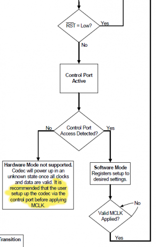

I was looking at this, and scanned the CS42448 data sheet to see if there might be a clue in there ... and maybe there is (DS648F5 page 28, Figure 12):
2022-09-27 13_08_30-CS42448_F5.pdf (SECURED) - Adobe Acrobat Reader DC (32-bit).png
I read this as saying that the internal registers should be set up prior to the TDM clocks (and in particular MCLK) being enabled, otherwise the hardware will be in an "unknown state" (and maybe it can't recover from that). However, as normally implemented with the static Audio library, all the objects will be constructed (and thus the clocks will be running) before setup() is called and the AudioControl object used to configure the internal registers.
If anyone out there has a system which needs the magic bit to work, they might like to try to make a test sketch which:
  • leaves the AudioOutputTDM out of the static objects, so the clocks aren't started at boot
  • first does the AudioControlCS42448::enable() call in setup()
  • and only then creates the AudioOutputTDM object and the AudioConnection objects needed to "wire" it to the source
Try this with and without the magic bit, from a cold power up or just after re-programming, etc., to prove one way or another whether it makes a difference and eliminates the need for the magic bit.
I'm not sure at this point how to achieve correct sequencing of clock and register settings for all cases, as I think some parts (e.g. the SGTL5000) actually need MCLK running before their control interface will work. But I'm sure we can think of something, if needs be... :cool:

I modified a general "is it working?" sketch, which outputs the channel number in Roman numerals on each output - well, who knows Morse code? Long is V, short is I ... but that's not important right now.
As shown, with #define USE_STATIC commented out, the TDM objects and their connections aren't created until after the CS42448 has been initialised. I put some delays in to make this easier to see; scope traces are yellow = audio VII, magenta = audio VIII, cyan = MCLK, green = I²C SCL:
With #define USE_STATIC active (not commented), MCLK is active before the initialisation takes place, as you'd expect.
With regard to the CAT811, I did check the data sheet and it could hold reset low for up to 400ms, which would undoubtedly cause problems. The one I have looks to be about 200ms (cyan = CAT811-/RESET, all other traces as before; timebase is different):
I don't have power-up issues with my board, and I don't have a library that sets the magic bit, either.
I recall at least a couple people saying CS42448 is quite sensitive to the reset circuit.
I only tested with the CAT811T chip. When I made the PCB, it seemed kinda overkill, but I had plenty leftover from the WIZ820 adaptor boards (the W5200 chip *really* needs a good reset). Now in hindsight, seems a part like CAT811T is probably needed.

for me it worked like this:
bool AudioControlCS42448::enable(void)
    Wire.begin();
    // TODO: wait for reset signal high??
    if (!write(CS42448_Power_Control, 0xFF)) return false; // power down
    if (!write(CS42448_Functional_Mode, default_config, sizeof(default_config))) return false;
    // set the magic bit!
    write(CS42448_Functional_Mode, 0xF4 | 0x01 );
    if (!write(CS42448_Power_Control, 0)) return false; // power up
    return true;
Thank you for sharing this easy solution that instantly solved my problems with starting up the CS42448 outputs, both at power on and after compiling the sketch.
