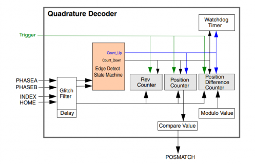

I think the two flag names positionMatchMode and positionCompareMode will create confusion. I know that I will always have to double-check which is which, and for someone new to the library, the names will seem to have the same meaning. Perhaps rename positionMatchMode to outputControlMode to match the terminology in the manual? NXP did not do us any favors by naming the output signal POSMATCH, even though it isn't always triggered by a match. I'm pretty sure that all users so far have been using the one original flag to enable/disable position compare interrupts, and the effect on Output Control was secondary.
Perhaps also update the comment on positionCompareMode to say Position Compare Interrupt Enabled, as opposed to Position Compare Enabled.
Not a big deal to change from positionMatchMode to outputControlMode not sure which way would be better. And yes NXP naming convention isn't that great. But think if we use outputControlMode may lead to more confusion that it controls overall output when it really is only applicable to Compare. Maybe compareMatchMode would be better. Most of the time its going to default to 0 anyway. And no - have no idea how to trigger a timer.
Mike, sorry for the nitpicking, but maybe reconsider the new function name resetCompareInterupt(). I think of "reset" as the same as "clear" to 0, not as "re-set" to 1, so I would find enableCompareInterrupt() to be more clear. If you do keep this name, please add another 'r' for Interrupt.
What my test program does after each interrupt is set initial (current) position back to 0 via write(), then re-enable the interrupt. As long as the current position is modified before the interrupt is enabled, repeat interrupts are avoided. I suspect that another way people will use the compare interrupt is to leave the current position alone and modify the position compare value. Can you add a function to set a new positionCompareValue, similar to what you did with write()?
Even that diagram is a bit misleading because the POSMATCH output occurs on position match when OutputControl = 0, but occurs on each/every read of the position registers when OutputControl = 1. That said, I'm okay with it the flag names as is. Your comments do explain the purpose of each flag.
